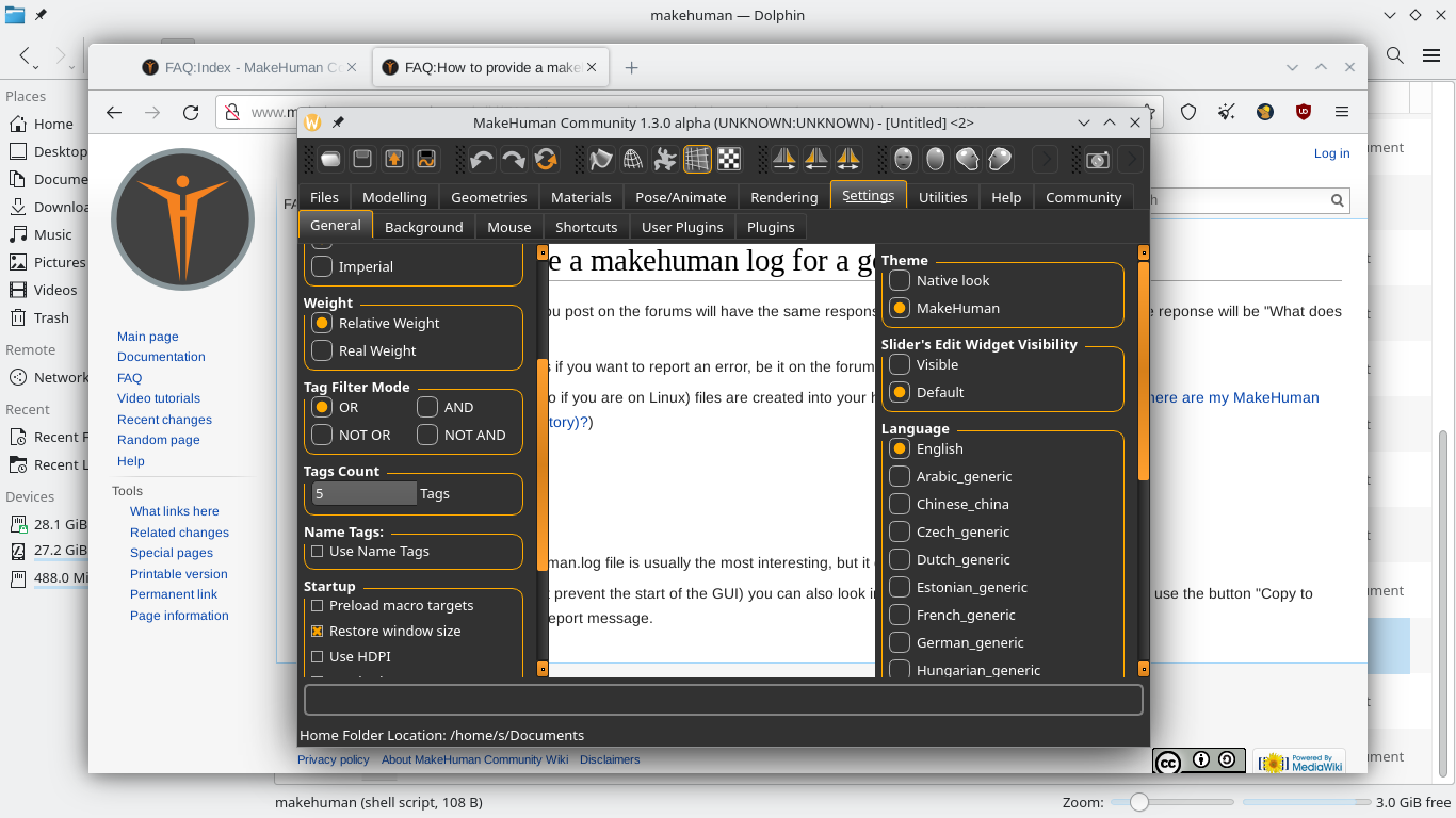

I compiled MakeHuman 1.3 on Debian 12 and it runs normally, except the 3D canvas is completely gone, not just empty:
I tried checking the "No sample buffers" and "No shaders" boxes in the settings menu as advised in the FAQ: http://www.makehumancommunity.org/wiki/FAQ:The_interface_looks_broken
But nothing changed.

VERSION: UNKNOWN:UNKNOWN
SHORT VERSION: alpha
LONG VERSION: 1.3.0 alpha (UNKNOWN:UNKNOWN)
BASEMESH VERSION: hm08
IS BUILT (FROZEN): No
IS RELEASE VERSION: No
DEFAULT ENCODING: utf-8
FILESYSTEM ENCODING: utf-8
STDOUT ENCODING: utf-8
LOCALE PREFERRED ENCODING: UTF-8
WORKING DIRECTORY: /home/s/makehuman-master/makehuman
HOME LOCATION: /home/s/Documents
PYTHON PATH: ./:./lib:./apps:./shared:./apps/gui:./core:/home/s/makehuman-master/makehuman:/usr/lib/python311.zip:/usr/lib/python3.11:/usr/lib/python3.11/lib-dynload:/usr/local/lib/python3.11/dist-packages:/usr/lib/python3/dist-packages:/usr/lib/python3.11/dist-packages
DLL PATH: /usr/local/bin:/usr/bin:/bin:/usr/local/games:/usr/games
SYS.VERSION: 3.11.2 (main, Aug 26 2024, 07:20:54) [GCC 12.2.0]
SYS.PLATFORM: linux
SYS.EXECUTABLE: /usr/bin/python3
PLATFORM.MACHINE: x86_64
PLATFORM.PROCESSOR:
PLATFORM.UNAME.RELEASE: 6.1.0-25-amd64
PLATFORM.LINUX_DISTRIBUTION: Debian GNU/Linux 12 bookworm
NUMPY.VERSION: 1.24.2
QT.VERSION: 5.15.8
QT.JPG_SUPPORT: supported
QT.SVG_SUPPORT: supported
QT.PLUGIN_PATH: /usr/lib/x86_64-linux-gnu/qt5/plugins:/usr/bin
QT.PLUGIN_PATH_ENV:
QT.CONF: NOT PRESENT
PYOPENGL.VERSION: 3.1.6
NOSHADERS: set via setting
NOSAMPLEBUFFERS: set via setting
GL.VENDOR: Intel
GL.RENDERER: Mesa Intel(R) UHD Graphics 600 (GLK 2)
GL.VERSION: 4.6 (Compatibility Profile) Mesa 22.3.6
GLSL.VERSION: 4.60
GL.EXTENSION: GL_ARB_multisample not available (0x samples)
GL.EXTENSION: GL_ARB_texture_non_power_of_two enabled
Thanks
