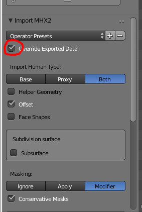

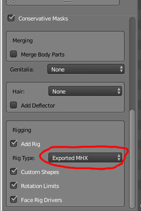

On MHX2 import you have to check "Override Exported Data"
then scroll down and choose your rig

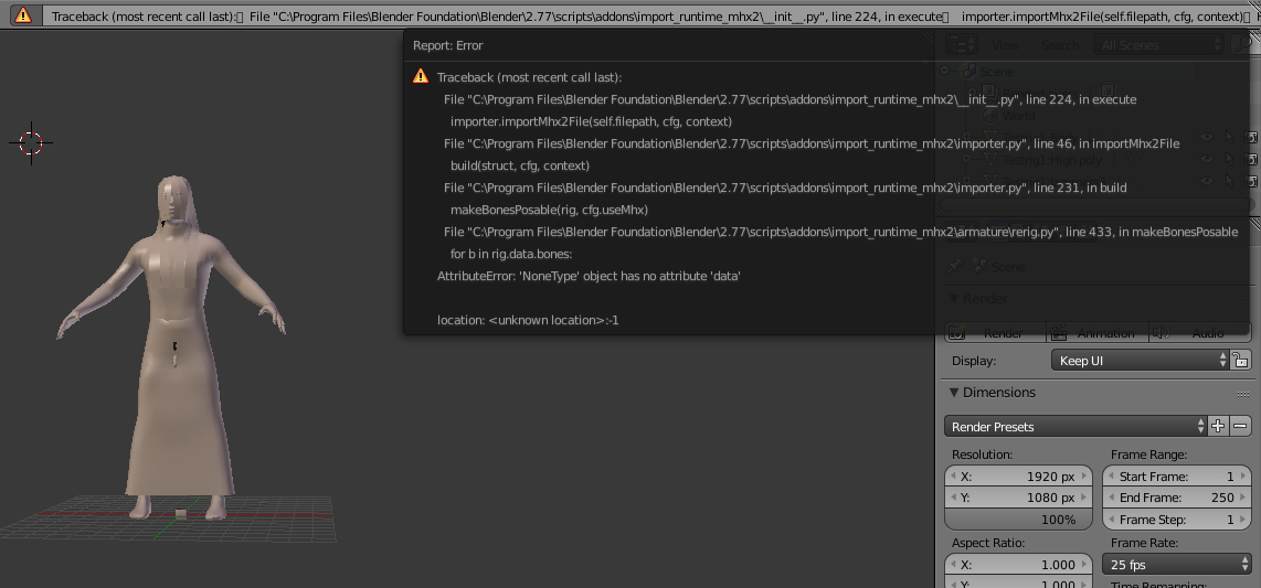

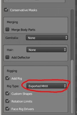

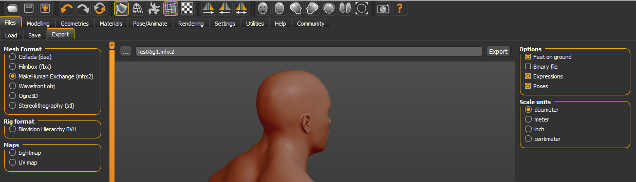

Postby blindsaypatten » Tue Apr 11, 2017 12:48 pm
Those are the settings I've used, but I get this error:
These were the export settings I used:
My Blender is 2.77a.

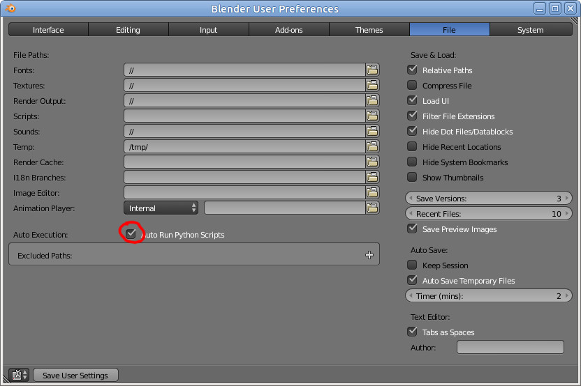

Postby wolgade » Tue Apr 11, 2017 2:46 pm
Did you enable "Auto Run Python Scripts" in Blender? It's disabled by default.

Postby blindsaypatten » Tue Apr 11, 2017 3:26 pm
wolgade wrote:Did you enable "Auto Run Python Scripts" in Blender? It's disabled by default.
Yes, it is checked.
