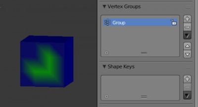

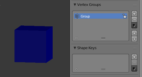

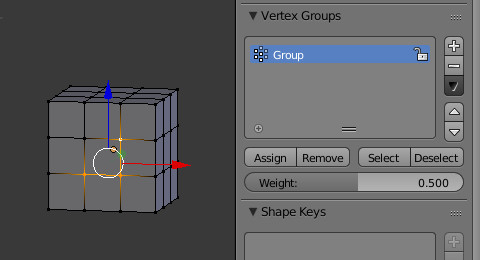

It applies the weight to the selected vertices. As I'm not entirely sure whether we're talking about the same thing, I'll show what I mean.
Unweighted cube. Switch to Edit Mode, select vertices, choose weight, assign weight.
Result:

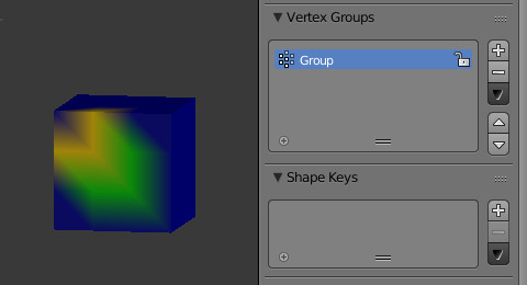

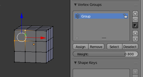

Let's repeat this with a different weight.

In your screenshot I see the weight slider, but I don't see an assign weight button, just an assign vertex groups button. Or... wait.... is that what the weight does? I assumed it was a slider that affected the whole vertex group. So what's actually happening is that every time you press assign, the vertices you just assigned to the group are given whatever whatever the weight setting was at the time.

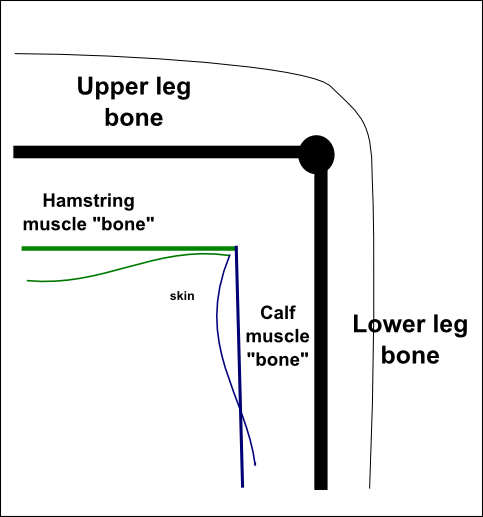

Edit:
I think this is a more accurate model of at least the back of the knee. I'm not sure of the implementation of the armatures so I'm not sure whether the two muscle "bones" need to adjust length and/or have a joint between them. The main point here is that the distance between the intersecting skin segments and the intersection of the bones determines the depth of the crease that is formed. In real life the crease is only skin deep.

You actually discovered the concept of having a deformation rig which is driven by a control rig. That's exactly how the MHX rig works. You might want to have a look at it.

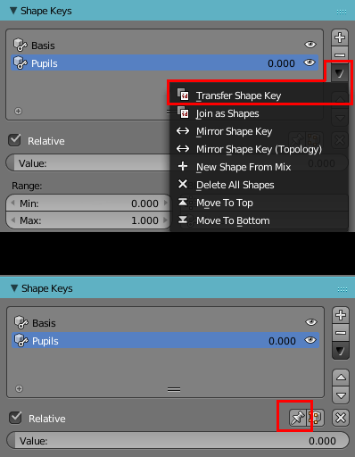

So here we are again with my extra bones I mentioned before --- and I hoped so much that I will never have to attach these bones again. I have used shape-keys also, btw. Does somebody know if these things are reusable? When I re-export my models I've to create the keys (and extra-bones) again and again ... I'm using keys for the size of the pupil in the eyes also btw.

I dont know about reusing bones but you can reuse a shape key by copy it to another mesh that have the same amount of vertices and topology. As I know you can only copy one shape key at a time.
Select the mesh, that have the desired shape key and select the shape key you want to copy.
Shift select the mesh that shall receive the shape key, then in the shape key window select "Transfer Shape Key". Unable pin.
Blender Transfer Shape Key
If the receiving mesh does not have any shape keys a "Basis" will automatically be created.
