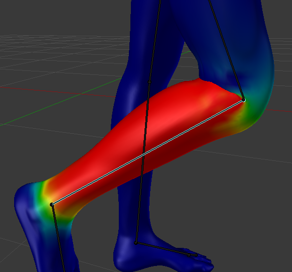

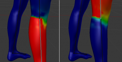

As far as weights go, this is how I understand it using the knee as an example. On the front of the knee you want a large overlap with a smooth weighting so that as the knee bends the vertices on the front of the knee will stretch out somewhat evenly to cover the now larger area, keeping the vertices relatively evenly distributed. On the back of the knee, where the vertices should be moving toward and into a crease, an overlapping weighting doesn't produce anything like you want. If you use two disjoint areas on either side of a crease line you will get a sharp crease that the vertices on either side will disappear into. While those vertices should really compress on the surface with a shallow crease there is no way to do that with a single joint and weight painting, and we really aren't too concerned with what vertices are doing once they have disappeared into the crease. I think that to do better you need to use shape keys.
Here's an example of disjoint areas of influence for the two sides of the knee joint:
and here is the sharp crease that results:
This is just to show the concept, I didn't put any work into the transition between the creasing back and the front area.
I think this is a definite improvement over the current default painting. I don't know if the crease causes any difficulty for clothing, from what I've observed clothing seems to deal with the creases around the hip joints so I'm hopeful it will be okay here too.

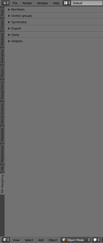

Looking at the code, it seems to be a blender add-on, located in "View3d > properties".
edit: Started testing "weighting" - it is in fact a blender addon. It's not very impressive when only a rig is selected, but when an object is selected, a LOT of stuff appears in the tab.
