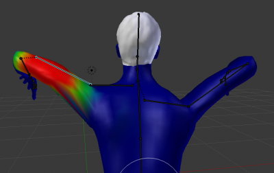

The placement of some of the armature joints relative to the mesh is off. This results in problems when the joints are posed any distance from the default pose. For example, the shoulder joint is placed far too low and this results in gross deformation of the mesh between the neck and shoulder when the arms are lift up and out to the side. I haven't learned how to properly edit the placement of armature joints yet but I did manage to produce this illustration of the effect of shoulder joint placement:
The shoulder joint on the left side has been moved up, the right side is the current default.
Please try your best to ignore all the other problems on the shoulder on the left, they are a result of my trial and error blundering in Blender, the relative point is that by placing the shoulder joint near the surface, as it is in the human body, you eliminate the downward deformations of the shoulder surface between the shoulder and neck.

1) You are using a skeleton with limited features.
2) To get your poses right you mostly have to rotate more then one bone. This is not an IK-rig! The shoulder bone needs to be rotated separately.
Depending on what you are doing you can try preserve volume (not so good idea on your example), corrective smooth modifiers and corrective shape keys. But the shoulder is problematic and has its limits.
(And just as a side note: we know the default weight map has glitches and some of the targets are not as symmetrical as expected ...)

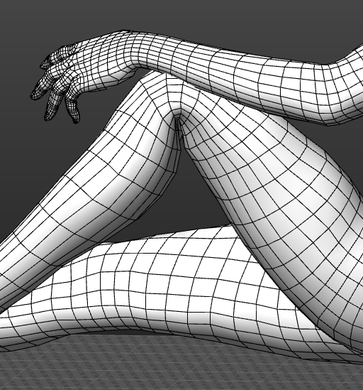

This is the knee from the Sit01 pose, all I did from startup was set muscle up and weight down and select the pose. The issue is there regardless of the muscle and weight but as you add bulk to the model the body parts overlap to a greater extent making the issue less obvious.

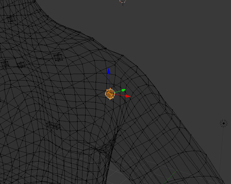

So it turns out that there are little boxes floating around inside the body that control the position of joints, and that I can create targets to move those boxes around. This could be easier than expected!
Edit:
So, the joint position problem is neatly solved (way to go MakeHuman authors!), next up is a way to customize the weight painting. Anyone know how to do it in a reusable way?
Knowing about those joint position boxes is important for people creating targets that affect joint positions, such as scaling.

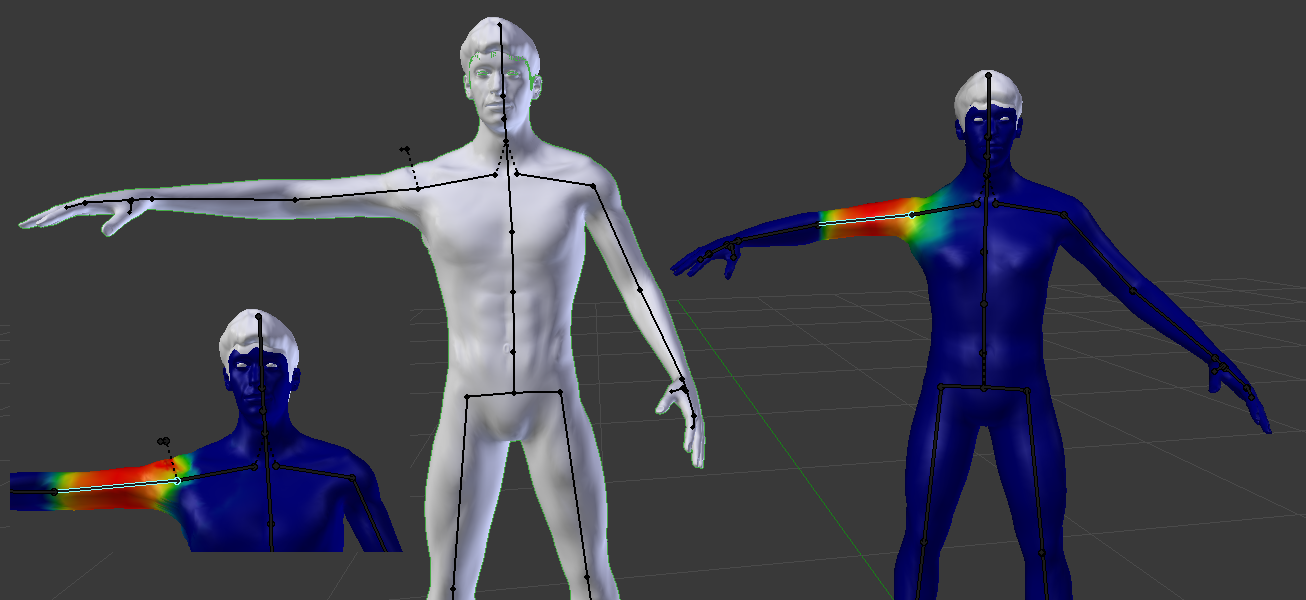

On the right you can see that the weights for the upper arm extend well over into the shoulder and even onto the trapezius, and you can see how the whole shoulder on the left has been lowered as a result, the exact opposite of what happens in reality. On the far left the painting has been modified to eliminate this issue. This seems to me to be the first most obvious fix to implement.
In the middle I added an extra bone floating above the shoulder that attenuates the creasing that would otherwise occur there. I can justify this on methodological grounds as representing the influence of the underlying muscles which is not reflected in the armature, which makes reflecting reality quite difficult. I'm guessing that people won't accept having a bunch of extra bones floating around.

The knees were relatively simple to fix, move the joint up a bit and fix the weight painting, of which the latter has the bigger contribution. The closer leg is the one has the weight painting mods. The current default looks even worse than the far leg.
