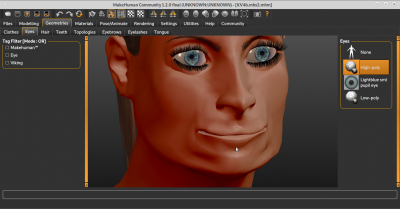

Hello. -Having a really frustrating time with my install. Running on Linux, from source, using the makehuman.py to start the application. I started trying to create some new eyes, and my first couple of attempts showed in the main window, just fine. At some point, under Geometries>Eyes, the list stopped being populated, almost completely. I get the high-poly and low-poly, and only one other eye besides the default brown. This one other eye is peculiar, in having a .mhclo file and an .obj file, unlike the other eye colors, that have been working before. Now they don't.

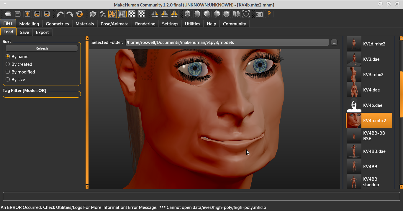

What really confuses me, is that when I load models that I have applied some of the other colors of eyes to, they load, vis:
I obviously have a high-poly eye, in light blue on the model. -But note the error code at the bottom of the screen. The program obviously thinks it can't load the eyes that are manifestly there, on screen. But when I go to Geometries>Eyes, that eye color is not on the list. The small-pupil light blue eye is a different file entirely, and not the same light blue eye that I stuck on the model, and yet, that pre-existing light blue eye still shows up. The high-poly eye IS on the list, and selected, but per the previous error code, the program doesn't know that. The high-poly eye files are still there, unchanged, in data>eyes>high-poly
Up until recently, I have been putting experimental eye images in the data>eyes folder, and they have been working fine. -But no longer. I downloaded the "small pupil light blue" eye asset. Note that it is the only asset besides the high-poly and low-poly eyes listed. It is also the only eye file I have found with an associated .obj and .mhclo file. I tried pulling those two files out of data>eyes, to see if the small pupil light blue eyes would disappear from the list, and instead I got NO eyes, and no other assets, either. No eyebrows, clothes, etc, and empty eye sockets. Put those two files back into data>eyes>materials, and bingo, the other assets have returned. -But still no other eyes!
Here is another screenshot of a portion of my data>eyes folder, showing the light blue eyes which are manifestly on the previously-created model, but NOT showing on the Geometries>Eyes list.
I have been reading and searching for this problem, a lot, lately. I am at my wits' end. Any ideas? -Thanks!
