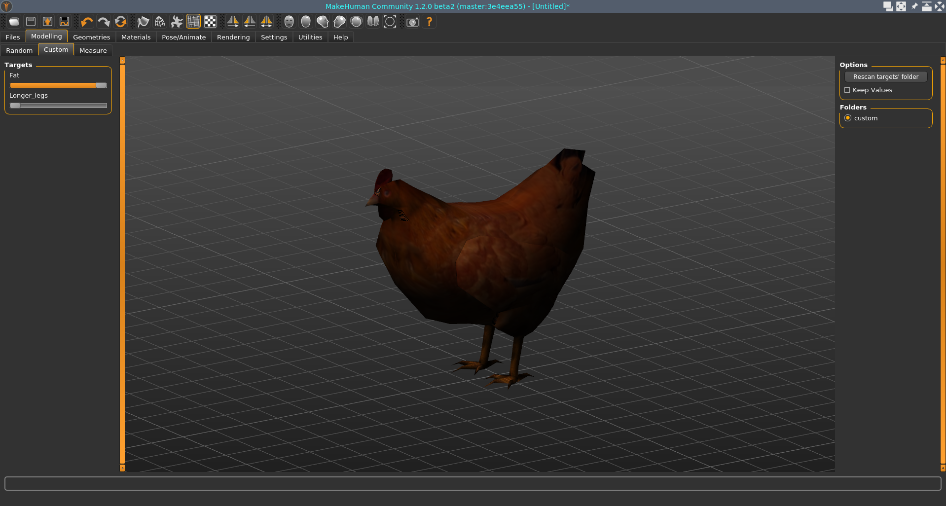

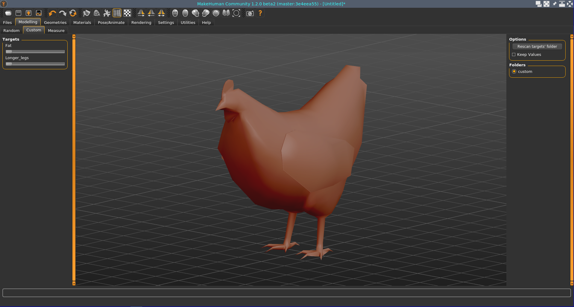

Postby chriku18 » Tue Sep 01, 2020 9:38 am
First of all: One image says more than a thousand words, so:
Both custom targets are working on the hen, but the pose tab is behaving very strange...
The steps, to reach this point were:
  • Get chicken from blendswap: https://www.blendswap.com/blend/13803
  • Remesh the triangles into Quads, realize then that clicking on triangulate would have also worked
  • Export as .obj (keep vertex order!)
  • Change makehuman/core/mhmain.py, as it assumes the basemesh is "good", but mine isn't, so the maxFaces of 5 is not nearly enough and who cares about speed... ?
  • overwrite default.mhskel using my script
  • overwrite default_weights.mhw using your plugin
  • edit base.obj to include joint-ground to stop massive console spam
  • export the texture as skin
I hope, that I didn't forget a step in this list...

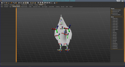

My script aligned all bones, as they should be (I hope):
The pose tab is broken anyway, but as makehuman isn't my main target, I won't search for the issue there (sorry). Same is for the modeling tab, as only custom modifiers seem to work.
If anybody is interested, I will upload my script and these files, but I see this as a success that creating a different basemesh is possible. This took me less than seven hours, but I think the next ones should go a lot faster, as it could be possible, that I have eliminated most of the bone-rotation-issues by now.
EDIT: Forgot to include a image of the final result (with skin)
