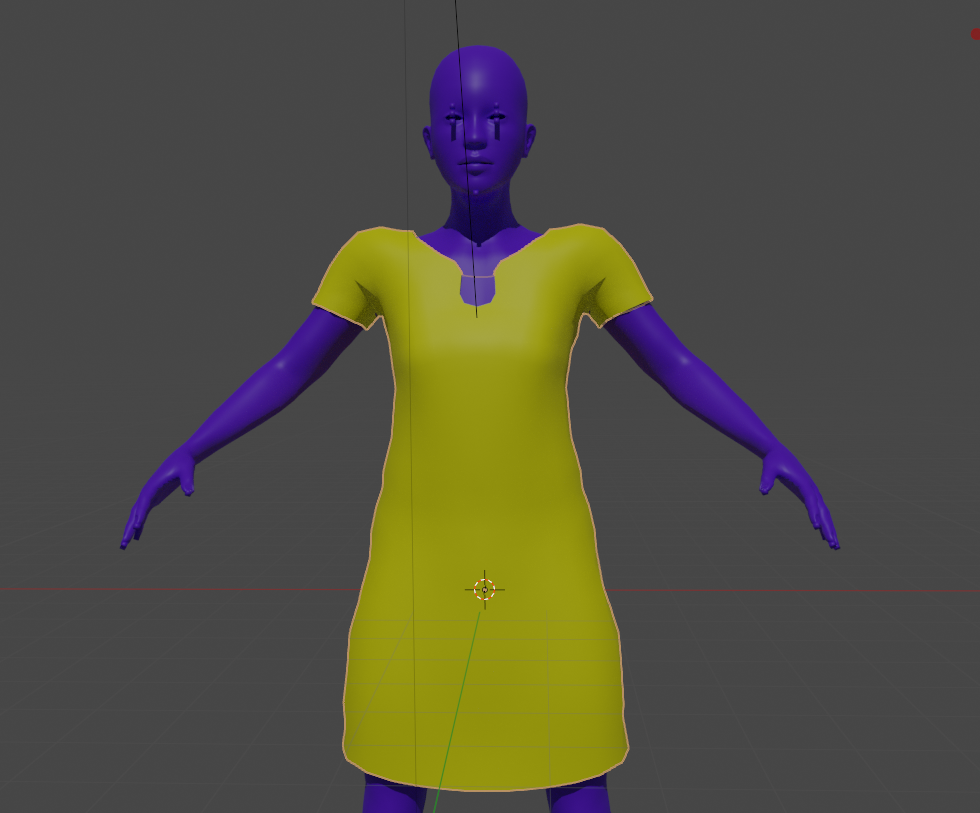

Here is a simple summer dress (1970s vintage and similar to one my wife wore when we were dating) that I created in blender.
In imported the hm08-ext human mesh, copied the tights helper and the skirt helper, deleted the human and modeled away. Imported a hm08 mesh and used it to create the clothing. Here is what it looked like in blender

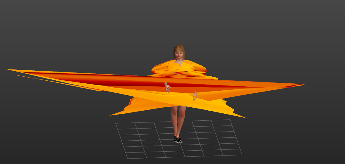

Ran MakeClothes2 and here is what it looks like in MakeHuman.
I seem to remember someone else running into this... what do?

It could be an apply rotation and scale problem but it could also be a wrong vertex order of the base mesh. Yes, this was the reason why added a new (and still hidden) feature. But you can easily activate it. Best way is to load the latest version of makeclothes if not already done,
Then read this text, please:
http://www.makehumancommunity.org/wiki/Documentation:ClothesV2
this section:
"Load a predefined human"
look at the lines on the yellow ground. Download the zip file and place unzipped files in the folder mentioned. After that it is a one-click action to get a prepared basemesh. That's how Elv and I work atm. Internally the chosen mesh is simply appended from a normal blend file.
I will send a PM this time. :)
