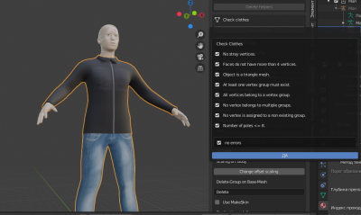

Thank you for your help, your advice really helped! However, immediately after this problem was solved, a new one instantly appeared. Now, when choosing the same clothes, I received the following error message
"Failed to index faces of mesh jacket1.obj, you are probably loading a mesh with mixed nb of verts per face (do not mix tris and quads). Or your mesh has too many faces attached to one vertex (the maximum is 8-poles). In the second case, either increase MAX_FACES for this mesh, or improve the mesh topology. Original error message: (<type 'exceptions.ValueError'>) could not broadcast input array from shape (11) into shape (8)".

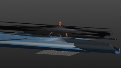

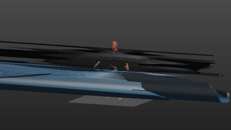

if I understand correctly, then MakeHuman complains that the mesh has a vertex to which 11 other vertices are attached, with a maximum of 8. If so, then I don’t understand what the problem is. In Blender, when checking clothes, a message appears stating that there are no errors (image 1).
When increasing the maximum permissible value, I get the following picture (image 2). Perhaps you know what could be the problem?

NotProUser wrote:if I understand correctly, then MakeHuman complains that the mesh has a vertex to which 11 other vertices are attached, with a maximum of 8. If so, then I don’t understand what the problem is. In Blender, when checking clothes, a message appears stating that there are no errors (image 1).
MakeClothes 2 is written with MakeHuman 1.2.0 in mind. You seem to still use MakeHuman 1.1.1.
It's not certain that this makes a difference, but you could try upgrading to see if it solves the problem.

Postby punkduck » Mon Jul 13, 2020 8:42 pm
Sorry for being a bit late here :(
Oh yes, it is directly visible what is happening.
Just to understand the output of old makehuman:
Makeclothes2 answers "object is a triangle mesh". In this case old makehuman complaints about number of edges ... and does calculation in a wrong way. Triangles are created as quads using one edge twice. And that was never really tested because "quads rule" ... (and avoid creativeness :( )
But this phenomenon of course creates the trouble.
One workaround in old makehuman would be to change max_pole e.g. to 16 in your .mhclo file.
The new version should handle this correctly.
If your piece of cloth still looks like "the mess" ... then your vertex-order of the human could be wrong. Normally I applied at least all scaling and rotation, so that should work correctly.
