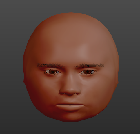

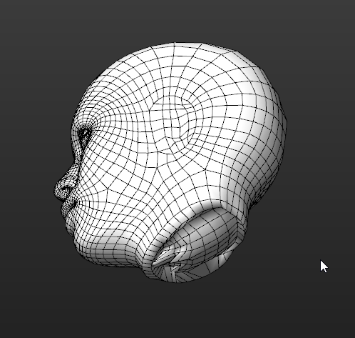

I'm trying to create a proxie for only the head, detached from the body.
The problem is I would like to have mesh close the neck.
My goal is to create a lot of 'sphere heads'..
The problem is that the mesh closing the neck gets messed up. Is there a way to tell makeclothes that some mesh is inside the human?
The geometry in blender before exporting to makehuman with makeclothes
blender wire

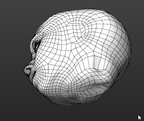

The geometry in makehuman as topology (renamed .mhclo to .proxy)
Thanks for any sugestions!

No, there is no special method to do it. But when you load all parts of the Ava character I did, most of the parts are inside the "human". So it obviously works.
The problem is, that faces of your clothes or proxies will try to follow the nearest vertices (vertex-triangle). And in your case it could be the inside of the mouth. Makeclothes uses the vertex-groups left, mid and right. A vertex assigned to group right will not follow a vertex of group left. So assign all faces of the body belonging to the head to a group called "head" and do the same with your head.
Don't use left, mid and right (so no "create vertex groups" on the proxy, or simply delete the groups Makeclothes did).
Leave out the faces inside mouth on the standard body. You can also use two groups like "head" and "neck".
Sometimes it needs some testing. As an example: For a lot of clothes I need to do special groups for the arms ... so that the sleeves will not stick to the body because body is nearer than arm. It is the same problem.

Postby joepal » Wed Jul 17, 2019 4:48 pm
This is because MH applies a few targets per default (33% of each ethnicity, 50% of each gender) whereas makeclothes operates on the raw base mesh.
There should be a combined target you can download which modifies the base mesh in the same way. You can use maketarget to load the base mesh, load this target and then model the clothes against this.

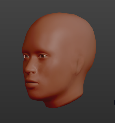

Postby smonbrogg » Fri Jul 19, 2019 11:10 pm
Ok, now I started to edit the mesh that was loaded by makeclothes before exporting, and I'm starting to get closer to my goal
Still the mesh is a mess, but I'm getting there :)

Postby joepal » Sat Jul 20, 2019 7:07 am
If you want to get a flatter surface on the neck cut, you could experiment with assigning a "*" group with those specific verts:
http://www.makehumancommunity.org/wiki/ ... ng_a_sword
It is not obvious it would be an improvement in this case, but it might be worth a shot.

Postby smonbrogg » Tue Jul 23, 2019 8:24 am
wow, that's a very helpful trick! :-)
just a quick test with the neck-cut gave much cleaner results using the * vertex group!
Now together with loading the default targets I'm pretty confident I'll get this working perfectly :D
