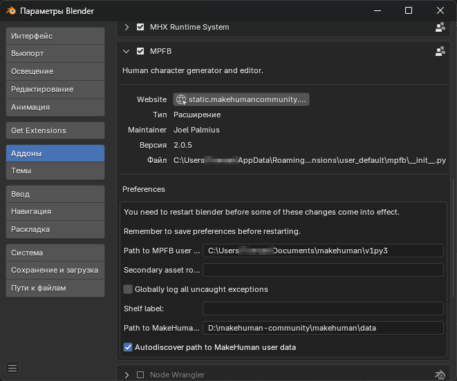

Can you take a screenshot of the preferences panel for MPFB? (ie edit->preferences->mpfb)

Postby tomcat » Fri Nov 08, 2024 2:24 am
joepal wrote:Can you take a screenshot of the preferences panel for MPFB? (ie edit->preferences->mpfb)

Postby joepal » Fri Nov 08, 2024 2:45 pm
These settings look rather strange. Maybe you mixed the settings of "MPFB user data" and "MakeHuman user data"? I would have guessed that it should be the "MakeHuman user data" box that should point at the path which ends in v1py3.

From my point of view, if it says “MakeHuman user data”, it is much more logical to specify the data folder of the program installation, and for everything else — installed separately — the user folder of the system. But my reasoning may look not quite logical in the light of the above considerations.
However, changing the path to the folders only resulted in the fact that even what was there was missing. Which is not clear to me at all. Why in the first variant skins and poses are displayed and everything else is not displayed?
