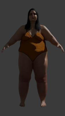

This woman is quite large, and many of the clothing items in the library do not fit her. However, the one piece bikini does fit her quite nicely. And so, using my single light and standard lens stopped down to around f11, I grabbed a shot of her standing default using the Cycles rendering engine. This setup yields very accurate images, right down to the texture of her swimsuit and her slightly oily skin.
Female 006 wearing one piece bikini
