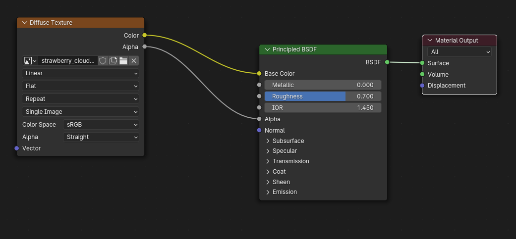

In general, the FBX export from MakeHuman is pretty shaky, especiall when it comes to materials. The recommended import path from makehuman to blender is MPFB, see http://static.makehumancommunity.org/mpfb.html
This said: my primary guess is that the texture node in the material (see the shader node editor in blender) did not connect its alpha output socket to the alpha input socket of the principled node, and that the principled node got a default alpha value other than 1.0 when created.
When correct, it should look like this:
You might need to adjust the material manually to get it to look right.
