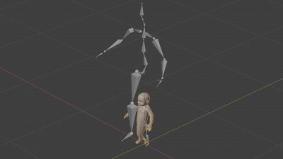

There was a task, to transform in animation one reference rig into another. The adult rig into a child's rig. This is what I got, only one leg is done:
0001-0100_3.mkv File size: 593.12KB
The problem is that when you apply "Armature deform", everything gets twisted…
This idea doesn't seem to be viable. Apparently we'll have to go back to mixing animations, but the engine doesn't take it well…

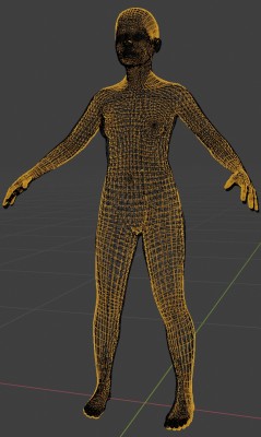

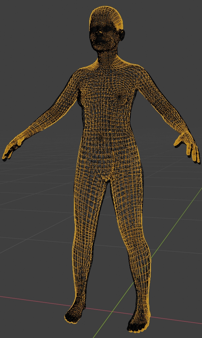

To elaborate: The default adult body is imported into Blender (25 years MH). Then a minimal child body (1 year old) is imported and applied as a shape key. If you change the influence of the shape key smoothly, the shape of the body doesn't match the body imported from MH.
For example, if the full transformation is 100 frames, then on frame 66 (100 — adult body), at the height corresponding to 13.5 years, it looks like this (the imported body is highlighted; the interpolated body is not highlighted):
How many intermediate shapes of the whole body are needed and in which places, so that the result in Blender would coincide with MH?

Postby joepal » Sun Oct 10, 2021 1:43 pm
Although almost all targets and macro modifiers are symmetric, age is not. Age is split up into sections:
* 0.0 - 0.187499 = baby morphig to child
* 0.1875 - 0.49999 = child morphing to young
* 0.5 - 1.0 = young morphing to old
That is, 100% applied macro targets are:
* 0.0 = baby
* 0.1875 = child
* 0.5 = young
* 1.0 = old
For other macro modifiers, you usually have a symmetric two-way or three-way split. For example muscularity is split into:
* -1.0 = minmuscle
* 0.0 = avgmuscle
* 1.0 = maxmuscle
While gender is split into:
* 0.0 = female
* 1.0 = male
Unfortunately, this also means that most conceivable combinations results in a specific target. Thus you have, for example, female-young-maxmuscle-averageweight-minheight.target for a young female who is very musclular, of average weight and very short. If the muscle slider is between max and average, you'd get a mix between the aforementioned target and female-young-averagemuscle-averageweight-minheight.target
So to answer the question, there are 348 macro targets to mix. But all of these cannot live together if you use MH or MPFB to do the morphing. You cannot have a mix between baby and old targets, nor a mix between maxmuscle and minmuscle.
