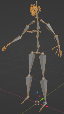

I have created a skelet for MPFB v2.0-a4.
The idea: a skeleton with many bones that works with mixamo.
mixamo does not support rigified character.
but i didn't want to miss the details in the face, and i didn't want to miss the hips.
my solution: I created a skeleton with MPFB suitable for mixamo, next to it I created a rigified skeleton.
I then copied the hips and the bones in the face from the 2 skeletons.
my character with 171 bones is taken over by mixamo, and i can use any animation.
since i am certainly not the only one with such a wish, i make my skeleton available to you, the skeleton is adapted to a neutral, unmodified human.
171bones works with maximo.zip
you have to need load the mhw-file (weights) too
