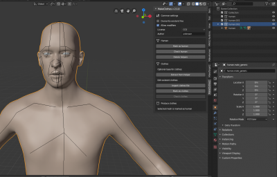

Hi, I just started using makehuman a few weeks ago, following youtube tutorials and reading internet pages, but i can't find anything on this.
My problem is that I'm using MakeClothes 2.1.0 and they all use a tab called "Vertex Group as Clothes", but I don't see it and I don't know what I'm doing wrong. Am I using the wrong Addon?
(I use Blender 2.8)
Here you can see it.

If you are using makeclothes 2 most of the videos and tutorials are not valid yet, as the addon is still very much under development(these videos no doubt refer to makeclothes 1). This is changing very soon. However please refer to this information as a guideline to how to use the new version of makeclothes dubbed convert clothes here http://www.makehumancommunity.org/wiki/ ... :ClothesV2 . Please note, that just like the addon, the information within is also very much in its infancy.
The new addon works very well, I and others are using it extensively at present, and most questions how to proceed can be answered if posed to those of us using the program. Feel free to ask any questions not answered by the wiki! Welcome,

I read that link, followed some steps and luckily it worked.
So "Vertex Group as Clothes" was something from an old version of MakeClothes 2?

I believe the button was replaced by "extract clothes from helper". Similar functionality. I am glad to hear the documentation was helpful and you are getting off the ground with your clothing building projects, feel free to ask any future questions as they arise! :D You testing the program helps it to develop further also remember.
