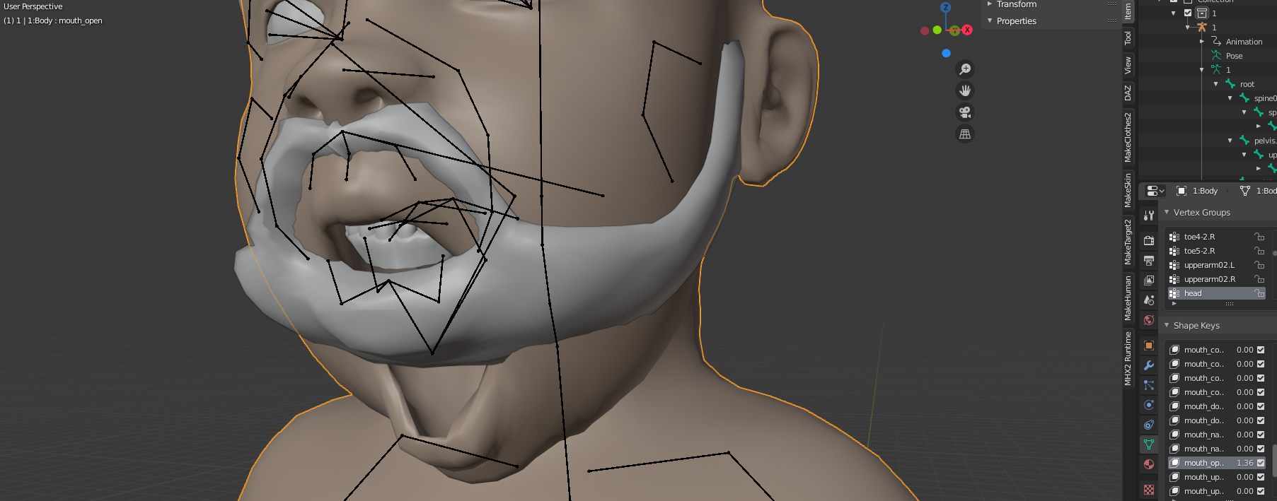

I imported my character with mhx2, in blender when i use face shape and open mouth beard not moving (in makehuman expressions its working) also mustache eyebrows not working too, How can i fix this ?

Face shapes are just shape keys (or morph targets) that influence only one object, in this case the human object. For further information about shape keys please refer to the official documentation of Blender: https://docs.blender.org/manual/en/dev/ ... ction.html. If you want to alter more than one object make use of the rig that comes along with your human. Checking your images you have applied, there is a skeleton with a full facial rig. Another solution would be replacing the beard object with a particle system...
