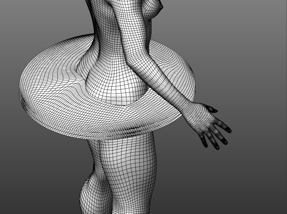

okay the big problem with assets is that anything NOT or Near the body gets very fiddley.
i now have a decent leotard (to be uploaded later) but i would like to of course do a few tutus/dance skirts. What hints do y'all have on how to set things up??
(my first tutu will be platter style* so its going to be the hardest to get right )

Use "rigid" vertex groups beginning with a '*' in the name, like '*group'. The group consists of three vertices on human side, though having a fourth one would be great. In a very quick and dirty test this method gave me the best results. It is build up of three plains with a hole in the center and a bit of shrink-warping of the 'hole vertices'

can i get a few details on setting up the groups?? on the tutu side do i set the entire tutu to say *tulle??
a test blend for you
https://dl.dropboxusercontent.com/u/539 ... test.blend if you could include a text file with instructions that would help greatly
the big thing i want to make sure of is that the tutu remains the same relative size when i shrink the model down in age (proper fit is the dancers hands just touch the hem when the hands are at a 45 degree angle)

Indeed I just made a vertex group called *tutu, on the human side it has two vertices on each hip and above the pubic bone. On the tutu the vertex group contains all vertices. I remade the file, kept very simple. I think it's self-explanatory, so it doesn't contain explanations. But I think it will not fit your special conditions about proper fit. Feel free to experiment with it and, of course, ask question, if necessary.
