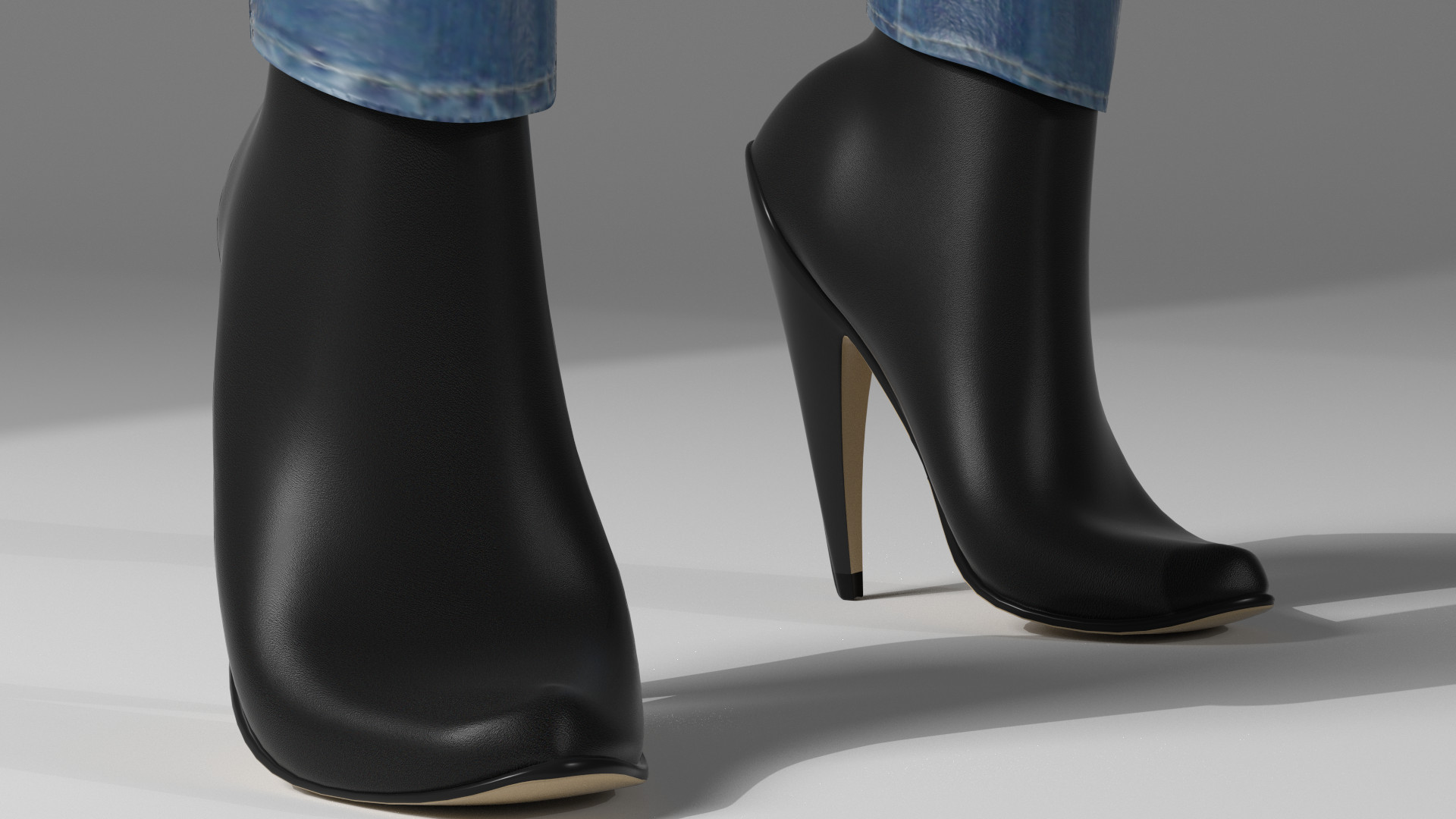

I really like this one http://www.makehumancommunity.org/clothes/universal_low_poly_high_heel_10cm.html. It's low poly but elegant, which I consider hard to do. It looks like something a woman would like to wear. If I tried to model this, I'd probably end up with something that looks like these concrete boots gangsters put onto you before they drown you in the river.

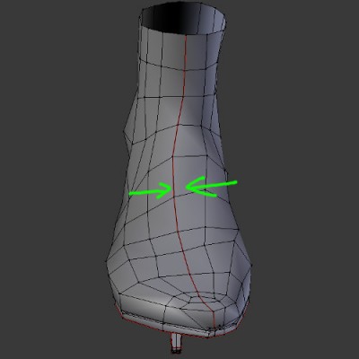

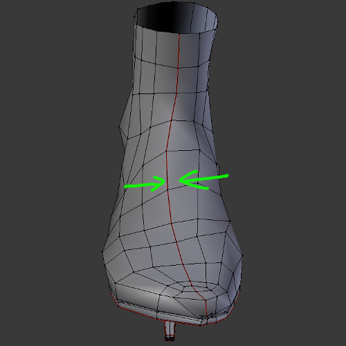

So I decided to give this asset a decent material. First thing I noticed was the uv layout.
There's a seam straight on the top of the shoe. This will cause trouble with a lot of textures, because it's visible and no real world shoe has a seam here. Let's change this. I moved the seam to the heel. That's where real world shoes have it, so it's not a problem if it's visible.
And this is what I got so far after some texture work:

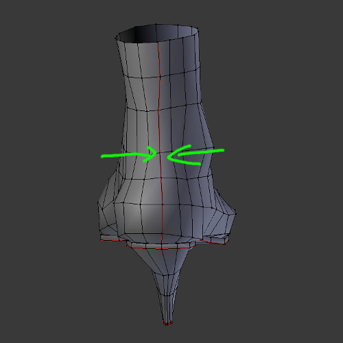

But here we run into another problem:
Heavy uv stretching. Reason: The object got unwrapped in the foot rest pose. The heel will never be posed this way in any render. It should be unwrapped with the foot pose applied. And this is where I'm stuck. How can this be done? It's easy to import and export OBJ-Files and keep the vertex order. It's also easy to edit an OBJ-File and just exchange the lines that start with "vt" (the uv layout), but there's no way to export the posed heel from makehuman and preserve vertex order.

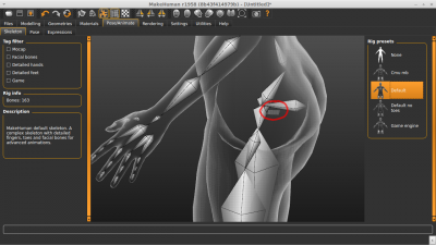

This thread nicely shows the difficulties of making high heels for mh. I'm playing with this issue for months now, and still got no real solution. I even tried duststorm's approach of exporting a default human with an armature as a substitute for the makecloth avatar (100% female, default armature, no eyes, no feet on ground, helper geometry on), but although it has the same vertex count you can notice that it's slightly off compared to the makecloth avatar.

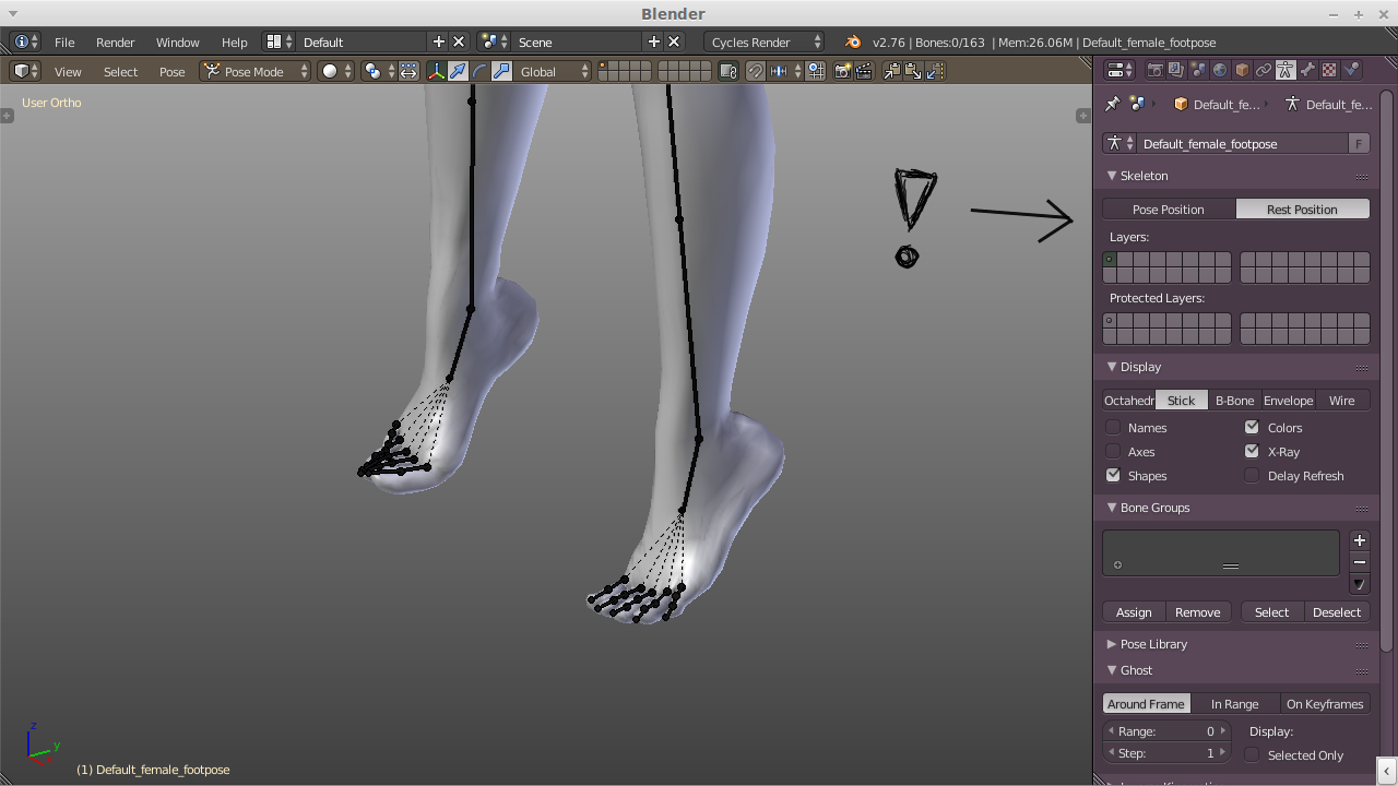

My personal solution atm is to export my model without shoes, but with a cloth that consists of only a small plane inside the body, which is pointing at the bvh "10cm", so the exported model will be in high heel pose after imporing it into blender.
The bones are where they should be, and this high heel pose is the rest pose.
Now i can model a shoe onto that, or append a pair of heels from my basemesh-library and adjust them to the foot.
For now i gave up making shoes that can be exported from MH. Too much weirdness. It's far easier to make them from scratch inside blender with a sole template, or tweaking a given model around the foot. Maybe one day there will be a makecloth avatar with an armature and an "apply as rest pose" button, resulting in an easy workflow for high heels without unwanted deformations and full functionality in terms of having toe control.
