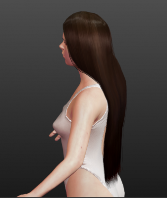

The secret is when you have your texture, then you start with 4 - 6 rectangle planes "strands", UV wrap these few to different sections of the texture as you desire, these are not used on the model just yet they are there so you can make more strands - pick one, duplicate it ( this automatically duplicates the UV as well), move it in place, bending and shaping as desired, once in place, you go back to one of your original strands, duplicate and place, duplicate and place... Painful process
but with patience you get the best results. my attempts using addons have never really produces something decent, but i dont have the patience to try the above.
And obviously you start at the lower part of the hair, i.e if you were doing the back you would start in the neck area working up, so that as you get higher the top strands overlap the bottom ones.
