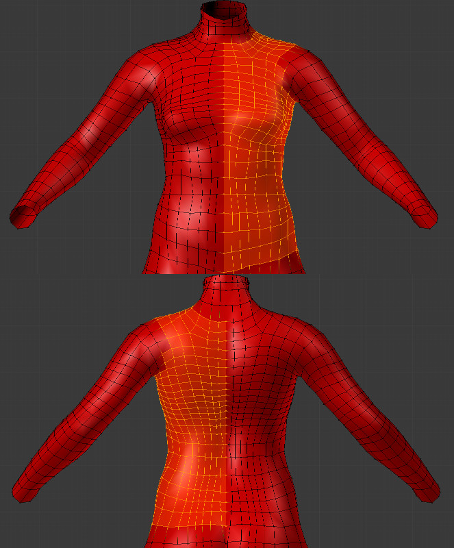

Make sure that your human vertex groups only contain tight helper vertices and no body vertices. It's important to exclude the arms from the vertex groups. Try somthing like this.

Here's what I'm using for the vertex groups:
Here's what the corset model looks like on top of the helper model:
