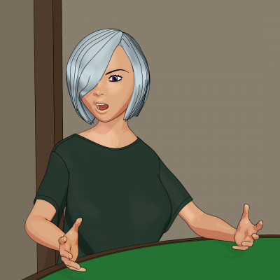

Postby DredNicolson » Thu Sep 07, 2017 12:56 am
Stylized renders featuring MakeHuman assets. All hope abandon, ye photorealists who herein enter. :twisted:
My Side of the Round Table
With more to come!

Love that clean uncomplicated toon look 8-)

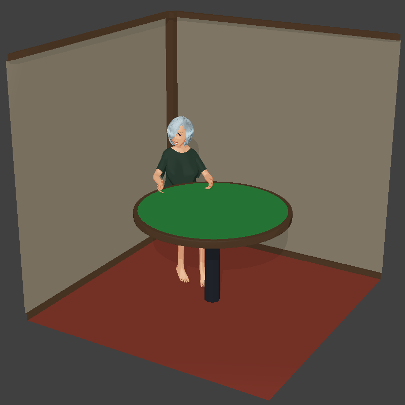

Viewport Shot of Entire Scene
As far as being lazy, I'll cop to not bothering to model a chair or stool, nor is she wearing any pants. :oops:
(That's not lazy, that's efficiency! What the camera won't see need not be modeled. :mrgreen: )

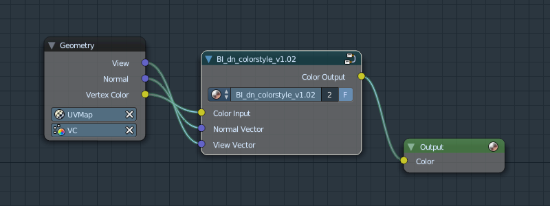

Coloring with Vertex Paint allows everything in the scene to use the same material (more efficiency!) You don't wanna see the plate of spaghetti inside that node group. :?
To keep shadows from melding into the darker toon band (causing ugly dark blotches everywhere), two sun lamps are used. One does the lighting, the other casts the shadows with a lower Energy setting (stronger light = darker shadows).

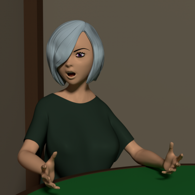

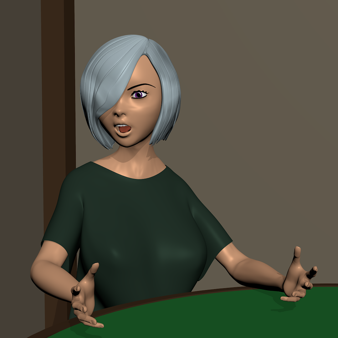

Postby DredNicolson » Fri Sep 08, 2017 5:41 pm
Blender Internal - Default Lambert/Phong
Cycles - Default Diffuse/Glossy/Fresnel

Postby blindsaypatten » Fri Sep 08, 2017 11:09 pm
Thanks for that, it's quite interesting. I can see aesthetic pros and cons of each.
