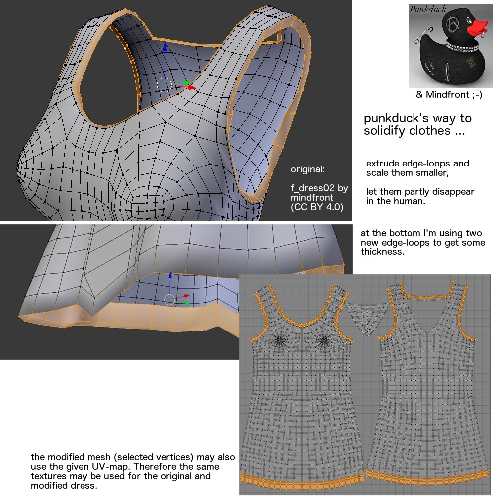

In the meantime I made a few modifications to Mindfront's dress to solidify it. I simply extrude some edge loops, see next picture. I was happy that Mindfront left some space in the UV-map, so that I can reuse his normal map and my new texture also fits to the original dress.
I will upload this alternative texture of course as a new material. Btw.: I reduced the size to 2048 x 2048 and recreated all stitchings, because they disappear when you shrink the original texture. I also added new ones, where the UV seams are. You might create a scaled copy of the normal map in this case, but it also works with the original file ;)

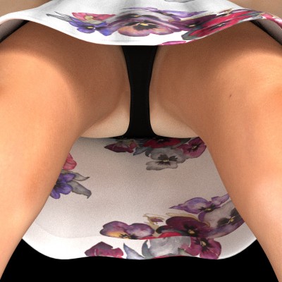

Well I will not but I have to add this picture to show that my method works very well without duplicating everything ... :oops: I put a lamp under the model ... y'know when I do that in reality have a guess what will happen ... :?
Normally the inside and outside has the same texture without doing anything, as far as I know. Only if you use a normal map, you get into problems. Then you may do it like Mindfront is doing it (by faking the normal-map entry in backface mode) OR you simply switch the normal mode off inside the clothes. Therefore you have to double the diffuse and glossy shader combination. One combination is connected to the normal map, the other is not connected. The mixshader selects the group by determining if it is the backface or not. When I use Mindfronts method the inside is still very dark even with the lamp I added. So, here is my setup:

You can make the interior faces appear in MakeHuman by adding
backfaceCull False
to the .mhmat file.
I think there's an easier way to accomplish punk's method: add a Solidify mod, check on Rim Only, set Thickness, copy the modifier, then apply them both. :D (Do this before you unwrap UVs and start texturing.)

For the alternative texture the backface culling is switched off in my .mhmat file. As far as I know I always switch this off and in my opinion in MH 'false' is the better predefined value than 'true' ...
Normally, I create rims for most of my clothings, sometimes I also create an inside and outside or real 3d components like buttons or ties. Of course I first create these things and then do my unwrap. Sometimes I unwrap parts in between e.g. when I create buttons where the same part of the texture might be used a few times etc.
But in the case of f_dress_02 I want the material to fit to the dress Mindfront has done and also to my modified version. When you do that with fixed points in the UV-Map, the new extruded vertices will be put to the same location ... so it took me some time to move them to the right location and get the desired result ...
