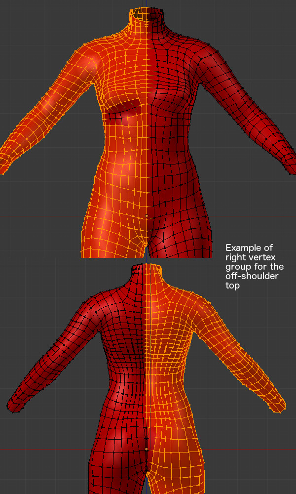

Turning on the grid and setting the T-pose is interesting.
1) Interesting mesh pattern
2) Some misassigned vertices
3) The tight jeans reacted in an interesting way to my adding a man bulge to the human mesh.
Turning on smooth is also interesting. I removed the jeans so you could see the underlying contours.

3) If you take the standing03 pose for a female character the middle of the crotch also becomes v-shaped. The seam between the left and right part of the jeans is assigned to the mid vertex group. And it is geometry to make the seam visible, not a normal map, so these are two edge-loops. When there is less space between the legs the problem will appear. A man bulge or even "genital volume" will make this also visible.
2) This is also happening with some clothes I made, for vintage top it works. But the uniform jacket is showing the same behaviour. The bigger the sleeve is, the more you will get distortion, I guess.
Well the last answer in "clothing color mess up" seems to be a good hint. If I do not use the left, right and mid groups, but instead will use e.g. left_arm, right_arm groups on cloth and helper, maybe I can predict the behaviour doing poses in a better way? I'm not sure, but I've to try it. Especially a poncho shirt might be something which needs these kinds of groups. I googled for some of these. Seems to be a good idea for my next piece of cloth, at least when I see the models in the net. I will definitely try it virtually ;)
May be if it works, I could create a new helper with more groups ...

I did not make a poncho shirt, it is only possible with cloth simulation, because this piece of cloth slides on the arms in some way. Or you have to build it like the vader cape of Grinsegold in different poses. But I played with own groups and maybe you are interested in the result. And I detected a problem, which I never really was aware of:
When you load a mesh with helpers, then by default only skirt and the tights contain the vertex groups left, right and mid. When you accidentally press the button "create vertex groups" with some or all faces selected on the human, eyes or whatever instead of your clothing, then the problem starts. I don't know, how often that was happening to me ...
Well for my new off-shoulder shirt I duplicated the groups to become leftoffshoulder, rightoffshoulder, midoffshoulder only on the tights and my new piece of cloth. Then I deselected some vertices (see picture).
It works a lot better now. I could also have taken the upper part of the tights and a few upper edge-loops of the skirt btw. ...
I like the result, especially that this piece of cloth does not use any delete groups. Advantage is, that it has no pattern, which can be distorted, and the normal map deforms in a good way. Here are some poses:
