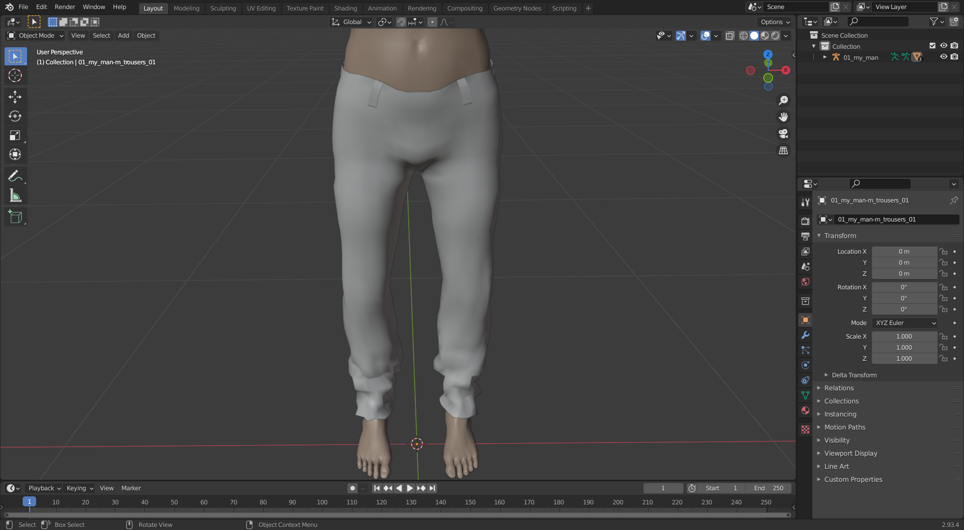

Postby eddy99 » Thu Sep 30, 2021 1:32 pm
I can't see anywhere in makehuman to increase the vertices. I have tried the smooth tab but it did not make much difference.
Once imported into blender the detail is already lost any subdividing make no difference.

First, going via DAE if your end goal is blender is an unnecessarily cumbersome detour. Recommended workflows for blender is going via MPFB for imports, or in worst case MHX.
This said, you shouldn't lose any vertices between MH and blender even if you go via DAE.
Can you post screenshots demonstrating what you see?

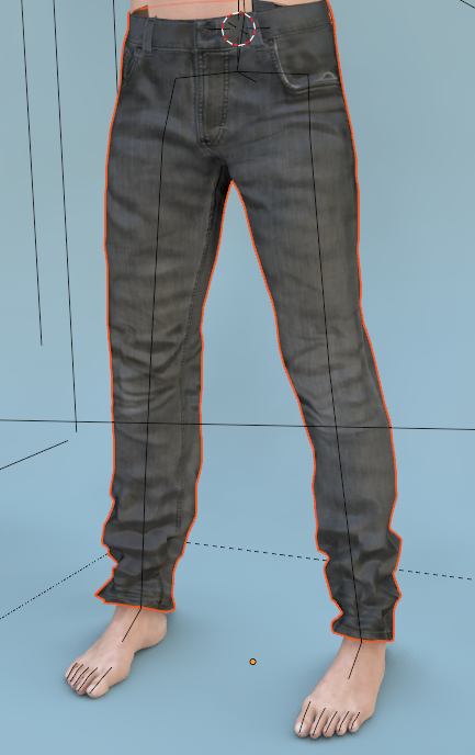

This isn't a question of resolution. The details in the MakeHuman view isn't due to having more vertices. It's due to having a normal map. The problem you have in blender is that you don't see the normal map in the view port.
Viewport:
Simply switching to eevee mode:
I guess it is possible that you might have lost the normal map in conversion via DAE.
In that case you can add it back by setting up a normal map chain in the material:
