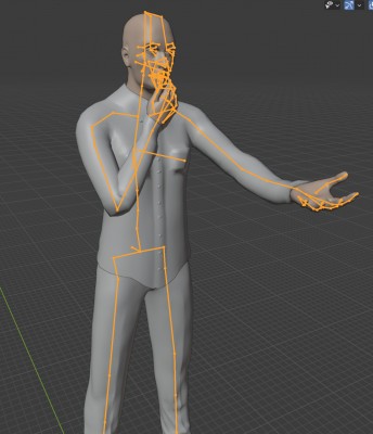

I am experimenting with creating poses in Blender and exporting them to makehuman.
Attached in pose.jpg you can see the pose I have in mind:
I've also attached the blender file.
I export this to bvh format (also attached)
pondertalk.zip
(3.07 MiB) Downloaded 749 times

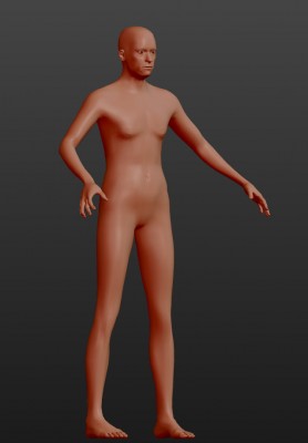

But when I use it in makehuman, it comes out wrong.
Thanks for any advice

Ok, I corrected that, but it still behaves the same way....
