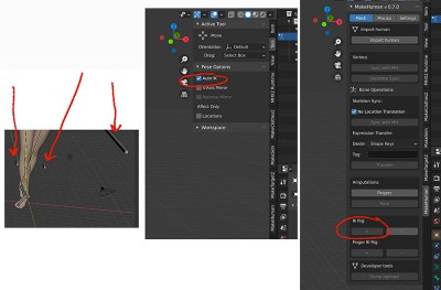

Started experimenting in Blender Pose mode with the MakeHuman addon. The attached file shows my interface. I checked the Auto Ik box in the Tool tab and the "+" button for IK rig. In Pose mode I now get these grey bars that I can manipulate to alter the pose. They work fine. Some older YouTube videos show a different method of manipulating the pose. The object has "rings" that can be used for manipulation. Is it possible to also show these rings with the newer interface?

The older videos show the result of the older import method "MHX". MHX is able to add a lot of different riggin/ik options, but is also an archaic and somewhat cumbersome system otherwise. You can still use MXH by downloading the blender plugin from the download page.
The import method you use in the image is MPFB. While being more modern and having many other nifty features, it hasn't quite yet caught up on MHX in regards to rigging options.
