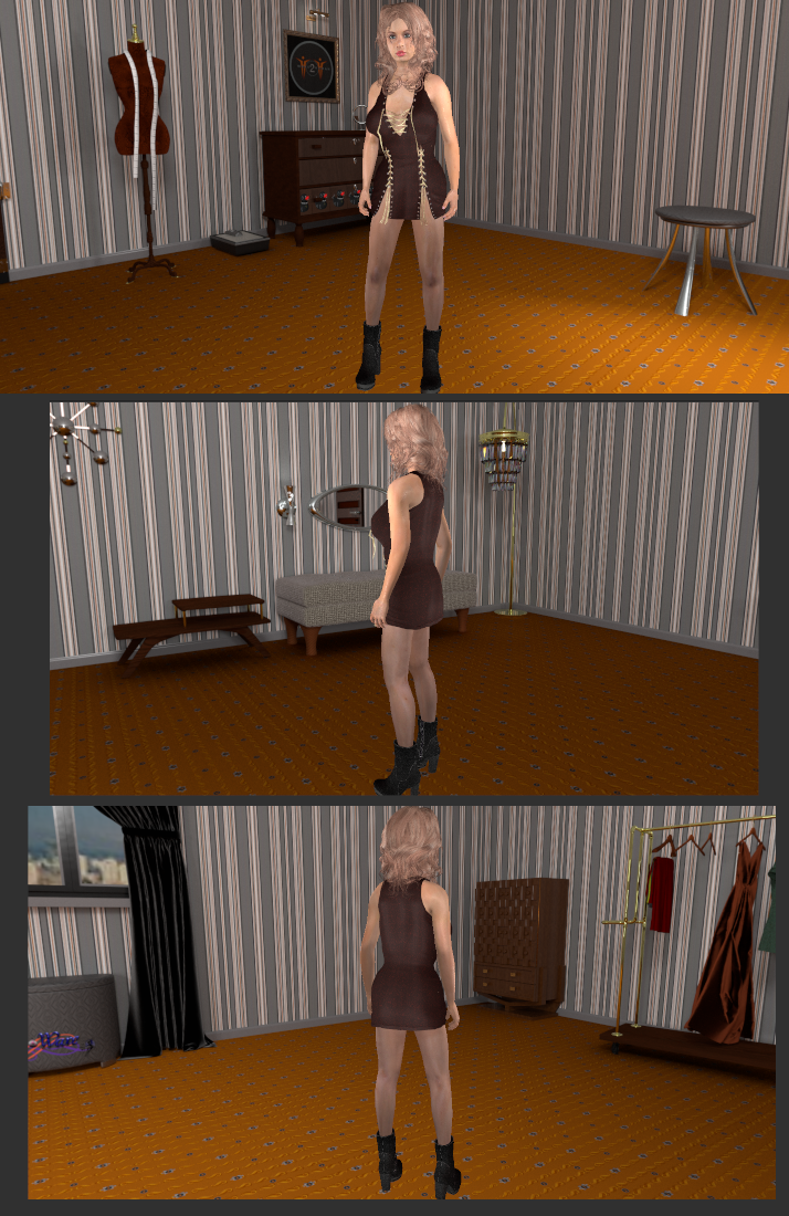

After that we tried own cube-maps. And here the chaos started. When one compares all these fine tutorials they all use a natural environment (e.g. Khronos). Now Elv created an own with some texts on it. They came out mirrored. I flipped the cube-coordinates ... well nothing changed at all :shock:
Okay I need to flip the image inside. Then I recognized that my mirroring when presenting metal shows the wrong side of the cube-map. I added a minus sign somewhere :lol:

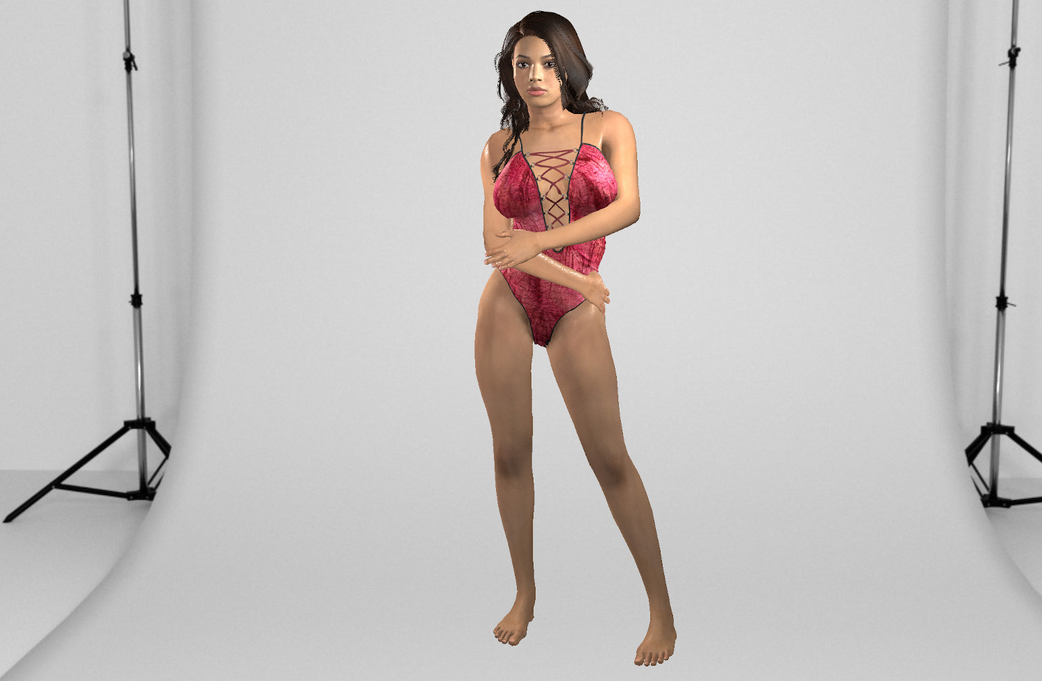

The standard is a clean photo-studio with our own textures now. It are jpeg-textures to keep the size in github small. The other new ones will be on own file-server, because they are bigger (especially as we will use png there).
This is the backdrop used in standard:
a fashion pose in front of a studio backdrop
and this is the room elv made:
perspectives of the cubemap

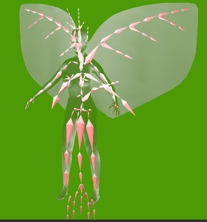

I also reworked the program to completely put an own basemesh into users folder. This may simplify work when we add a complete new base to our existing ones.
I remember Elv and I did a basemesh with helpers for tail, wings, fishtail, animal ears and some jiggle bones.
This mesh works with the common targets (which of course only influence the "old" basemesh + helpers still).
This was achieved by adding all new helpers after the old mesh.
Here is an image, the body itself is stolen from my Dani character to show that the "old targets" already do something. It is weighted already.
ghost image to make bones visible.
