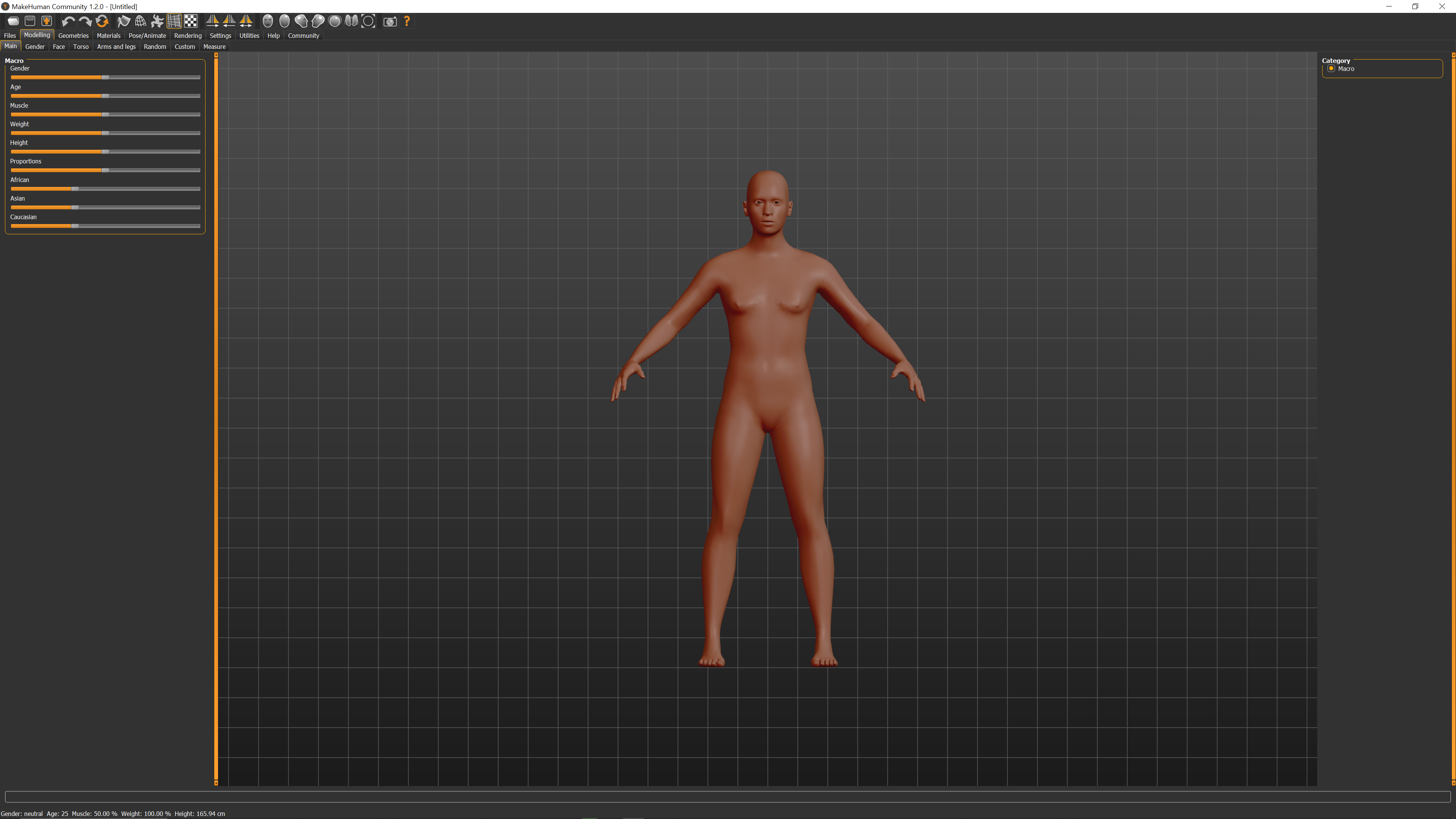

the old first screen

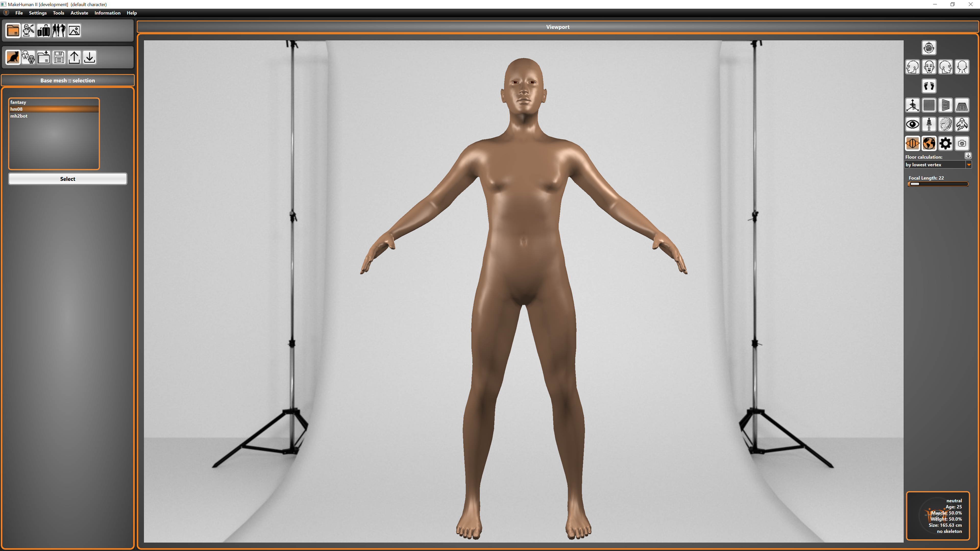

load the base mesh
