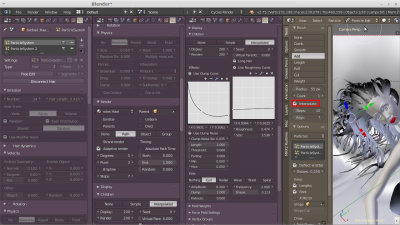

The hair was easier than i thought. The interpolated strands worked pretty well this time. Here some settings for the hair:
hair shader
particle system for left skulp
first particle system for right skulp
second particle system for even longer strands at right skulp
To prevent the children strands to grow on weird spots, it's best to extract a skulp-mesh from the avatar. Placing each strand manually gives full control, enabling children and "interpolate" fills the gaps.

I'm impressed by the hair, it must have taken hours to have it rest naturally like that without any of it passing through any of the meshes (or maybe that's just me).
Re: Sep. '15 contest contribution: "Deflowering Rose"
Postby grinsegold » Wed Sep 09, 2015 11:14 am
jujube wrote:It must have taken hours to have it rest naturally like that without any of it passing through any of the meshes.
No, not really. As i mentioned earlier, there is this "Interpolate"-button in the toolshelf of the particle edit mode (where you comb the hair). You create a hair particle system with zero strands, go into particle edit mode, add your first single strand and pose it. With "interpolated" enabled, blender tries to guess where any further strand would grow, so if you proceed adding strands manually, they will easily look usable. A bit like child strands, if you will. If you watch closely the pictures above, you will recognize that i only added 149 strands in total, using this method. if some strands poke through the cussion, just comb those edit points up. That needn't to be perfect - noone will notice.
All in all, this won't take much longer than an hour or two, including tweaking (combing single edit points). Try it, it's fun!
