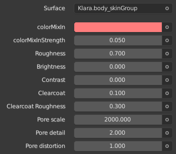

This will create a node group with convenience inputs:

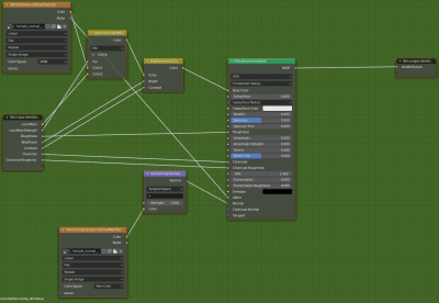

Which internally currently looks like this:
In the longer run I plan on adding support for a generated bump map for skin pores etc, but for now it at least makes it easy to vary skin tone and shininess of imported characters even when they come from the same skin material.

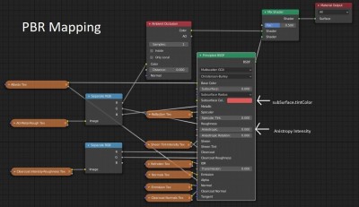

Representing this as data is probably a good idea from both a design & flexiblity standpoint. I know my exporters (JSON & inline Javascript) bound for BabylonJS right now are probably gonna choke, on this though. I have also looked at the source for glTF exporter, & think it will not work. I realize Rob was not referring to downstream of Blender when he commented, but coming up with something really custom will be trouble unless it just going to be used in Blender.
Seems some of this node group is just holding values for principled, seems like just assigning the principled node would have both the same effect, yet make it much easier for downstream.
I am also wondering about the use of principled's subsurface color for skin. I can export sub-surface & BabylonJS uses it (don't think glTF has it yet). I ignore it when the color is the default red. Had to also ignore it because you are setting it to white by also checking that subsurface > 0. White is terrible, I am not sure why you are changing it. Given that I did some tests of other objects, & think it might be useful for skin. I have not gotten around to putting in playing with subsurface in my PBR export tester (see my topic in this sub-forum), but here is a side-by-side snapshot I did while adding subsurface to the exporter.

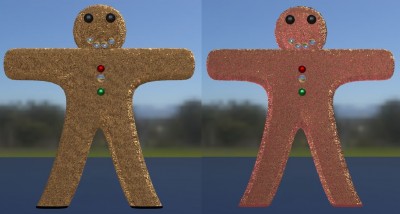

The cookie is a little thin & this is shown in an environment texture with a very bright sun from the back right. Certain areas kind of look like sun burn. If I get a chance, I'll see if doing something on skin seems near equivalent. Please keep this off the master branch for a while.

After more checking, this was a 2.80 transition change, I seemed to have strattled. In 2.79, the default was a shade of red. It did not change to white in 2.80 until very recently. It is still in my screen shots of how I am mapping for export.
Subsurface where I export to is not implemented the same as it is in Blender, but I have just mapped the Subsurface property > 0 as the sole switch as to whether to export or not. I set the value == to the amount of transparency. I also got really good results. Here is a pastie red head, using subsurface & turning roughness all the way up on the hair.
If subsurface works at all like here, this might be another option, which will also might be easier to export. As long as I have an option to not get a node group, I am fine.

Continuing work on the optional enhanced skin blender material, I have now added a procedural texture for skin pores. The effect is subtle, but in the first image you have the default skin (with no pores), and in the second image you have the enhanced skin (with pores).
The effect is most visble if you click on the second image and look on the breast side in the lower left corner of the image, or on the shoulders.
Control of the pores is done via group inputs:
All this is still in a feature branch: https://github.com/makehumancommunity/m ... node_setup
