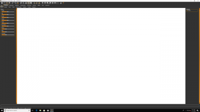

The assets downloader works pretty well on my Windows 10 system, but I don't see anything on the modeling screen. Am I supposed to? I mean, it loaded up really fast -- a lot faster then the current release -- but is that because not all the parts are in there yet?
This is what I see when the program first loads...

thanks for giving feedback! I'm sorry for you having problems with the program. Checking your log file it indicates an OpenGl problem. We are aware of that problem. In fact the Gl-Code needs to be rewritten, which are greater parts of MakeHumans libraries. And finding the right API for the refactoring task, that support multiple platforms and also older hardware, will not be that easy.
Perhaps you could provide some further Information about your system (which CPU and GPU). Is there a possibility to switch to another GPU? Can you retry on that one?

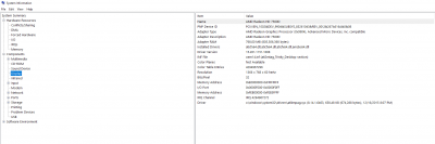

My Windows 10 system has just one GPU, and it's not a very good one.
I use a Mac for most of my work, and the Windows system is located in another room for when I need Windows for something, like MakeHuman, which doesn't seem to run quite as well on a Mac.
I use CoRD to access it over my home network and sometimes I use it as a sort of crude render farm.
I made a screenshot of the system config, I hope it's useful....

Well, this time it's AMD causing problems. Actually the GPU should be enough to display MH, this is not hardcore gaming. I once successfully ran MakeHuman on an Atom 2600, without extra graphics card. Though the performance left a lot to be desired. The basic problem is MakeHuman uses deprecated (legacy) OpenGL functions. That means functionality heavily depends on the support and implementation of the graphics card vendor, with e.g. Apple completely removing all GL support. Writing further platform independent code isn't that easy. Best choice would be using Vulkan API. It should then run on Linux and Windows and there will hopefully be a compatibility library for Apple products. But if we should switch to Vulkan, which for sure will take a bunch of time (Joel will mostly has to implement it), you and I can throw our systems out of the Window, due to lacking Vulkan support...
