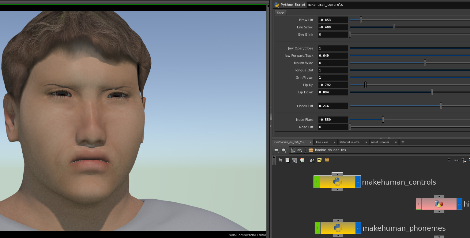

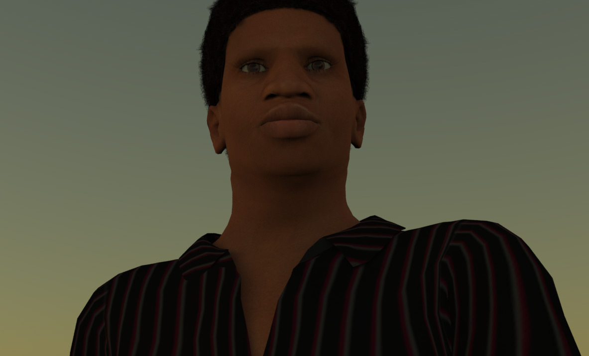

Hi All,
I am proceeding down the path of importing MakeHuman exports into Houdini.
I have a companion thread going on od|forum if anyone is insterested but I thought I would post some information here as well.
I am using the MotionBuilder skeleton with all the facial bones. I export this in the FBX format.
Inside Houdini I am writing a python rig controller that adds facial control and phonemes to RIG.
Here are a few initial face poses I have been able to achieve.

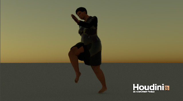

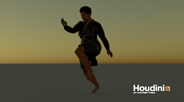

Postby Atom » Tue Dec 15, 2015 9:09 pm
Here are a couple of shots from the python auto walk script I wrote in Houdini.
Generous leg lift and arm swing settings for the diabetic type-2 African female model.
The auto walk also adjusts posture in subtle ways, with hip, spine and neck tilt.
