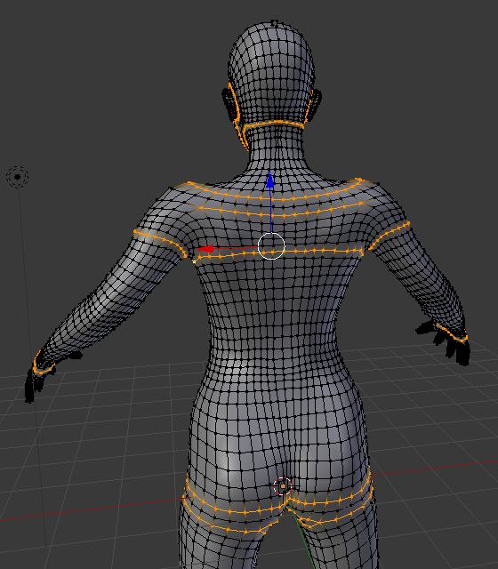

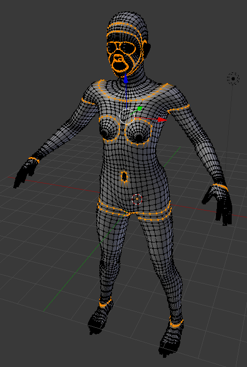

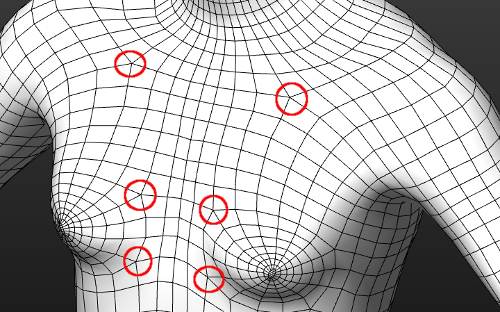

Marco_105 wrote:Ok, so its like Ngon ?
Multiple edges. One of the design goals MB had for the main A8 model was to minimize the number pole verts with more than 4 edges. There are very few on the whole model. I've marked a few.
5 edge poles

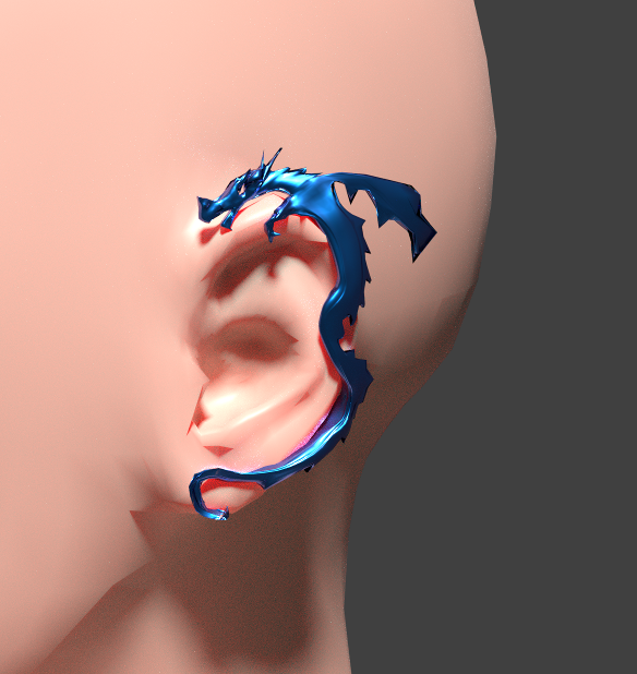

Was thinking to do some of the stranger types of jewellery that you get.. as an example - although this is very rough work.
But yes interested in peoples thoughts.

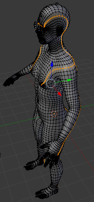

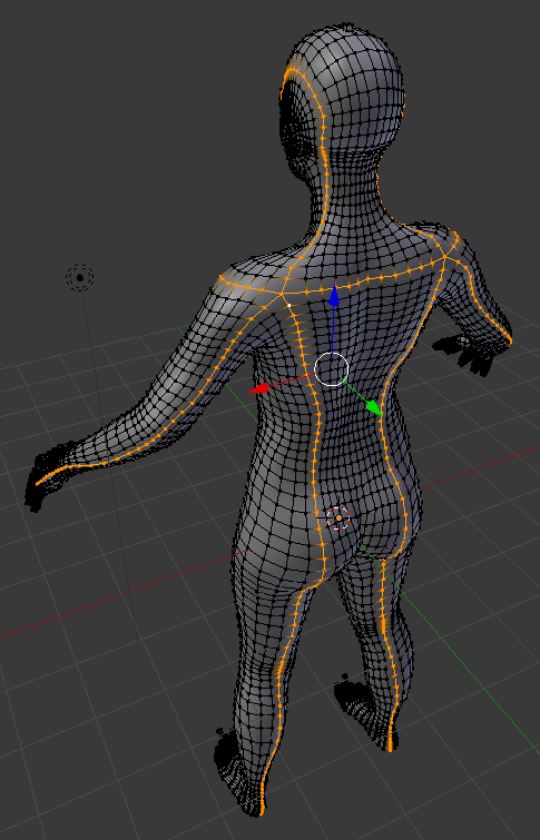

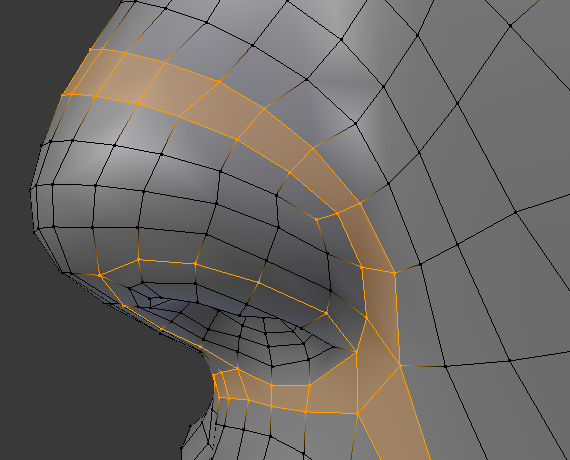

Postby blindsaypatten » Tue May 09, 2017 11:06 am
5-poles usually occur where two cylindrical meshes are joined together:
But there are those two in the base mesh that seem to be different:
and one pair of 3-poles:

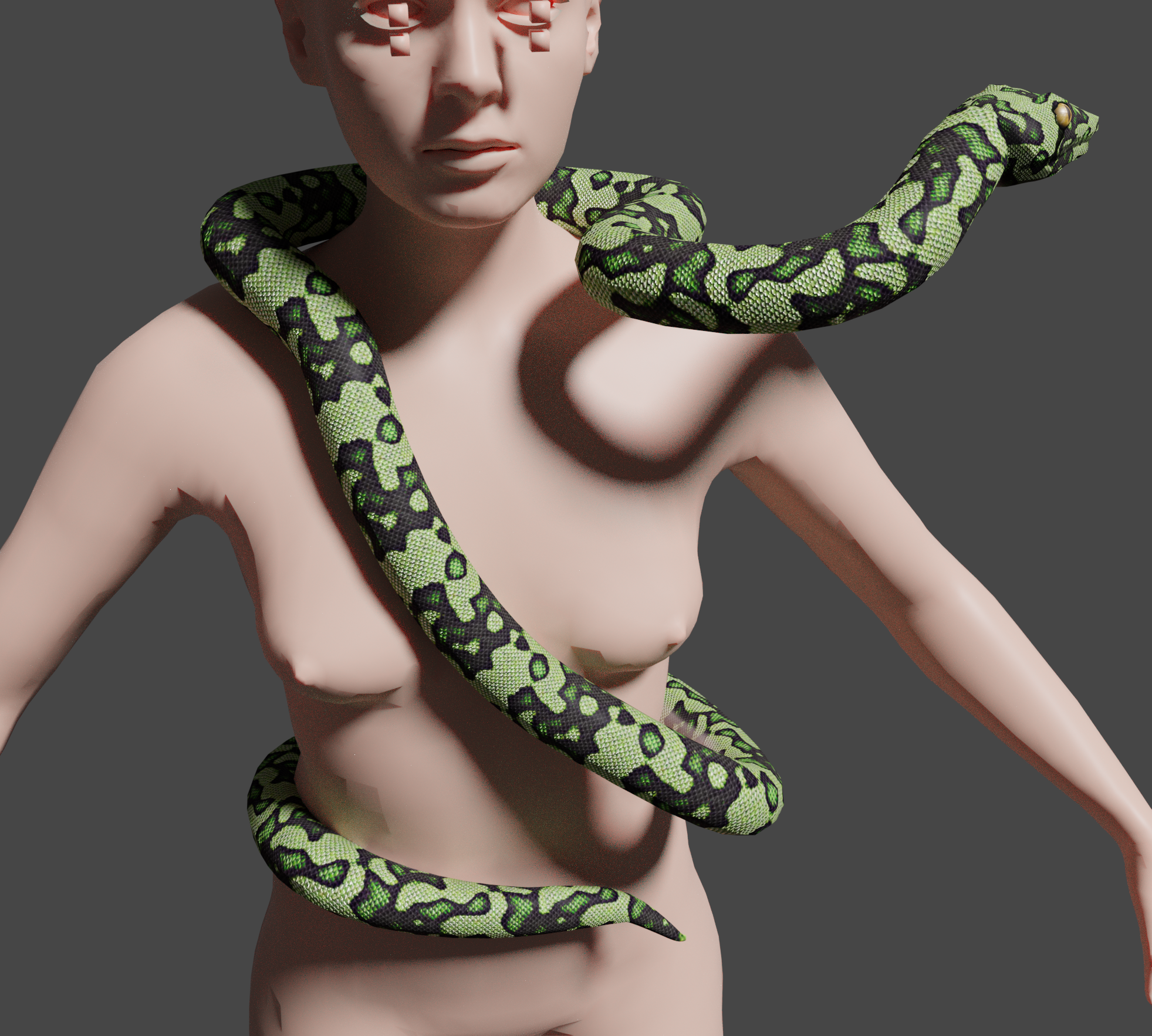

Postby o4saken » Wed May 10, 2017 8:50 am
Decided to try do something a little more different( an actual Python, and not script :D ), i actually really like it. Its basically a bezier curve, converted to mesh.
i set the z-depth to coat, hoping that it will sit on top of other clothing... not sure.
Oh and strangest thing, for the 1st time ever - using absolute paths, i never got the texture not found error!!! yay for small successes, it even had all the textures in the exported folder, so although i cant test it, i am pretty confident the textures for this one is working.
