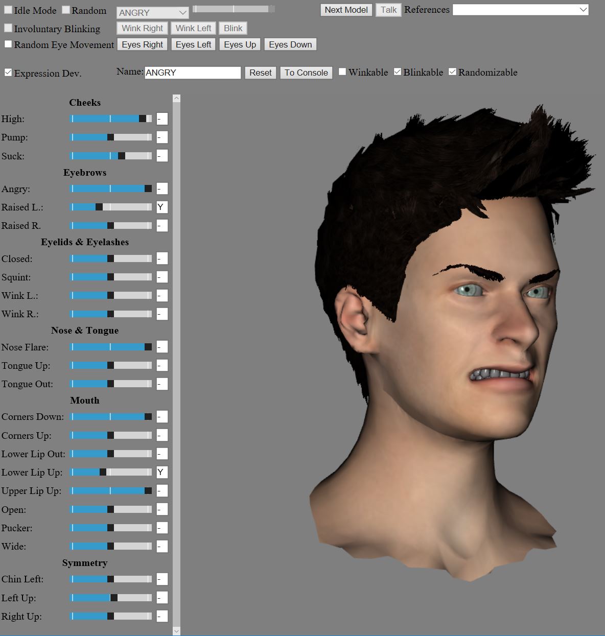

I have also gotten Nate Hair to work. I cannot remember whether I just edited the .mhmat file or assigned the material / textures in Blender. I should also note the vertices count is very high. I then used a limited dissolve of 10 degrees delimited by UVs.
Virtually no degration, but exports from Blender in a much more compact form as show below. A little dark here, but I am only using light.

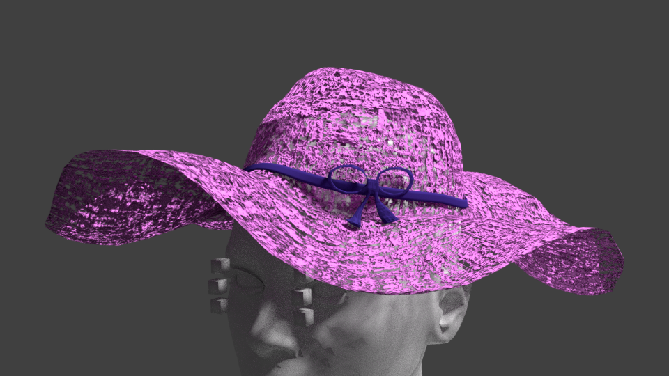

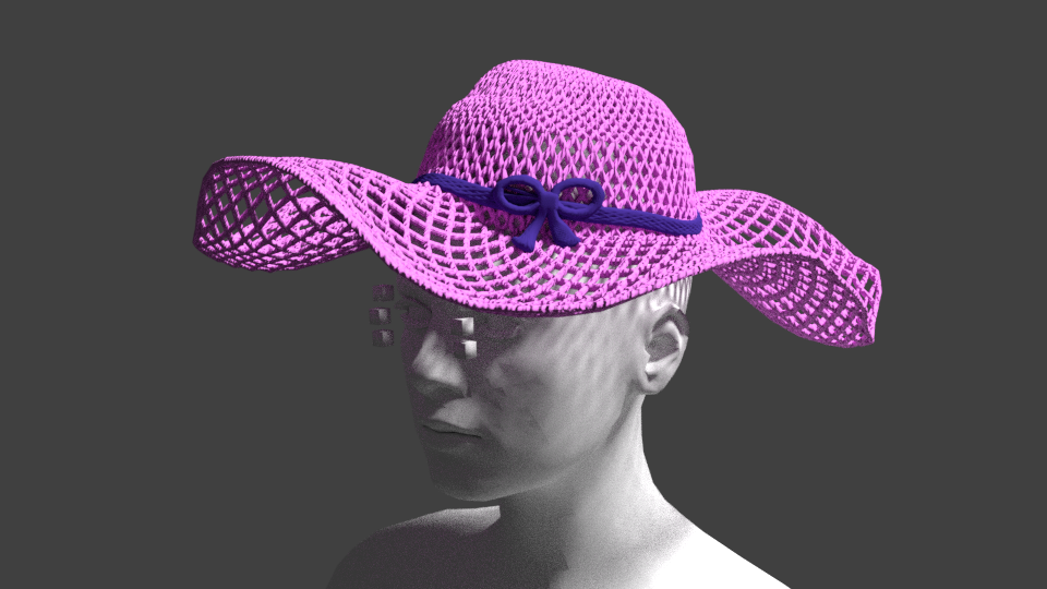

Just a very simple beach/summer hat

Further playing with the summer hat, i just took the mesh and converted it to bezier curves, as simple (low polly) as i could, then converted it back to a mesh.
Was more of an experiment, but the result is actually quite pleasing

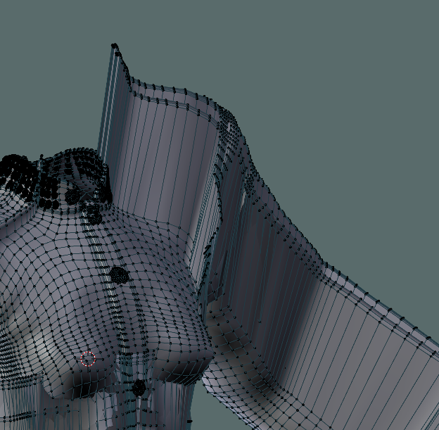

I try 'Test Clothes' with latin dance asset in BL, I got that :

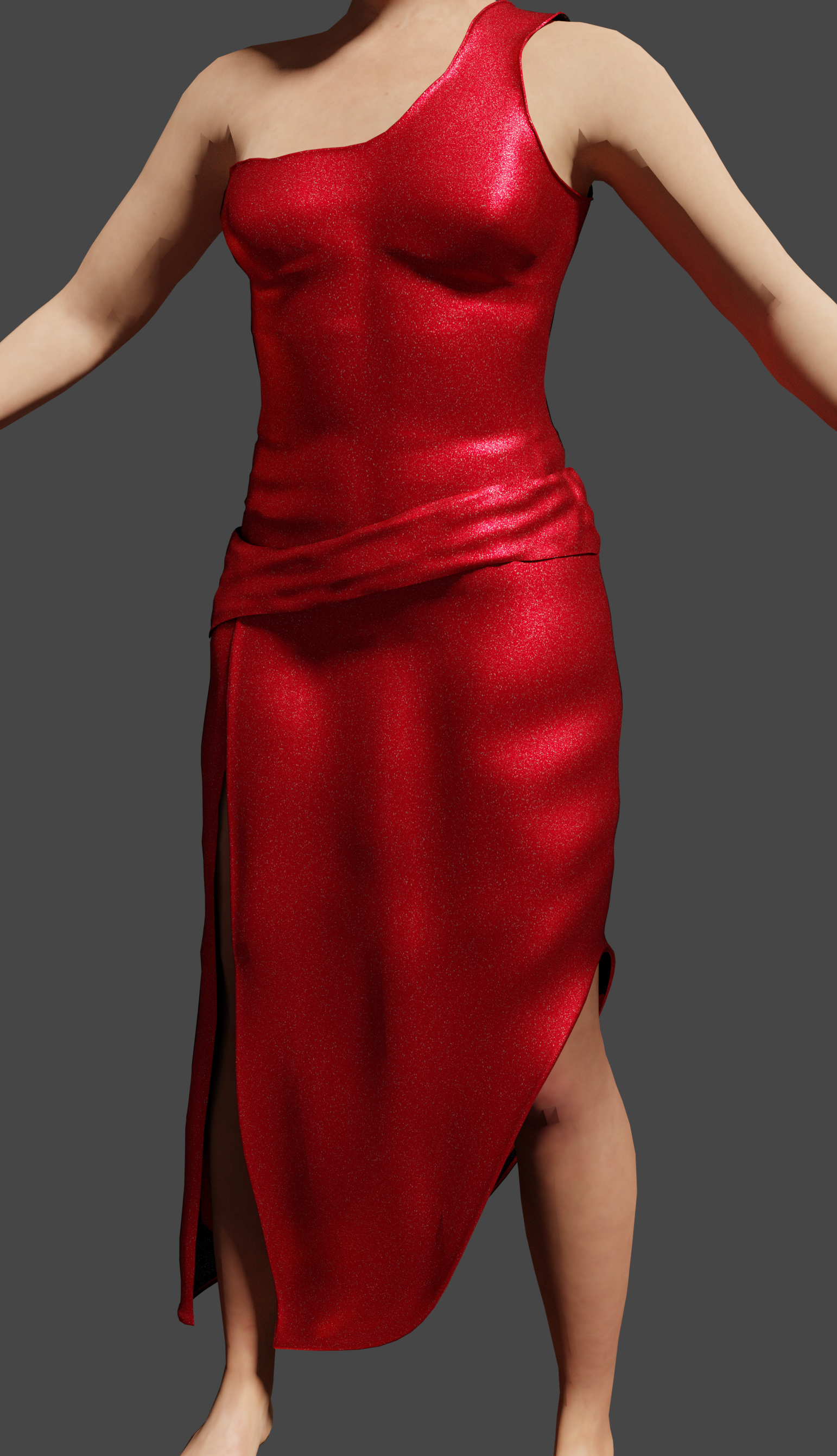

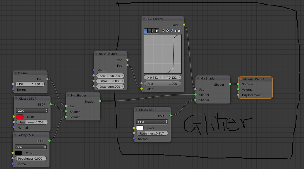

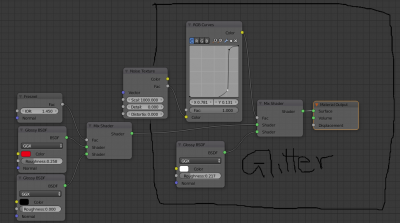

Right so i was playing with textures in blender and came across this method of adding glitter to an object, then in my excitement i quickly threw together a dress to try the texture on - anyways so there is no diffuse image and rather it is all made using cycles nodes:

Postby wolgade » Thu May 04, 2017 10:15 am
o4saken wrote:i quickly threw together a dress
It looks damn good for being thrown together quickly. BTW: You could replace RGB curves with a color ramp. It might be a little easier to adjust.

wolgade wrote:It looks damn good for being thrown together quickly. BTW: You could replace RGB curves with a color ramp. It might be a little easier to adjust.

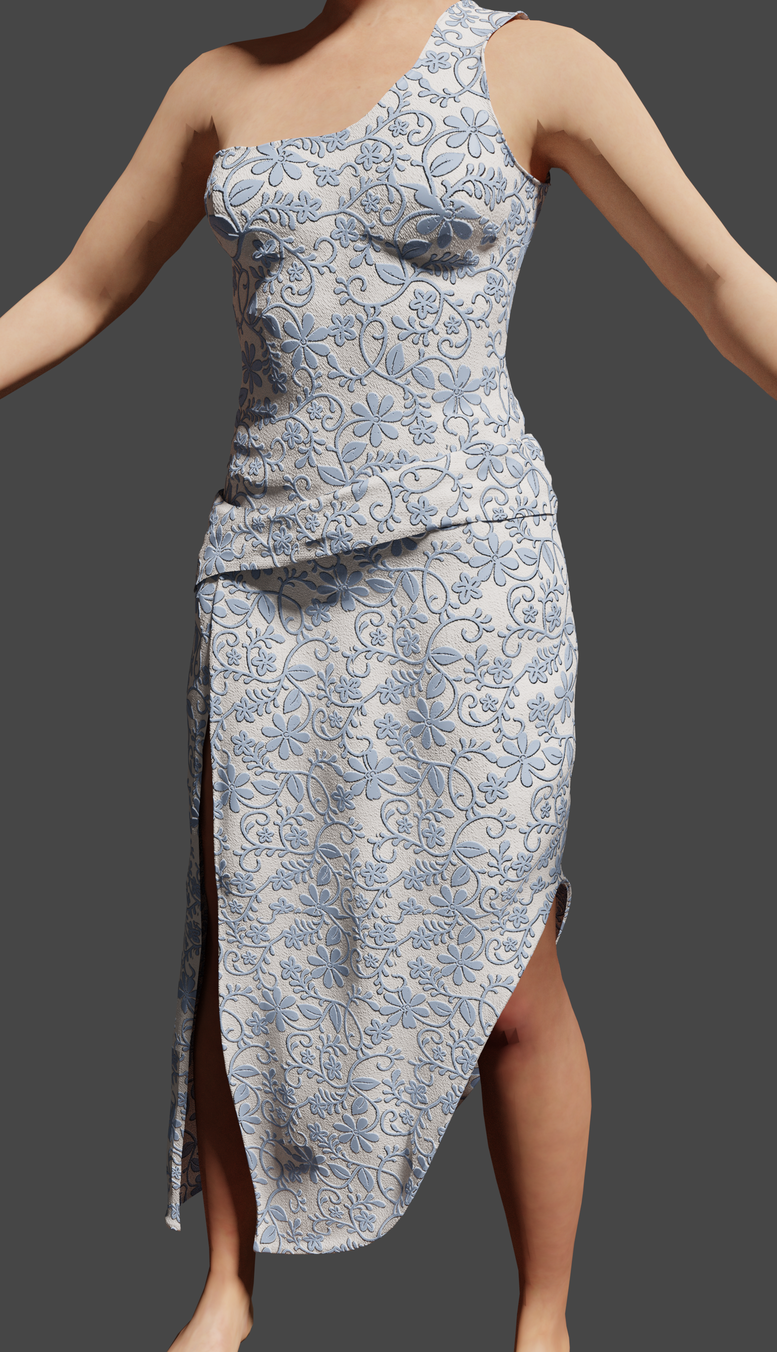

Thanks, i will definately give the color ramp a go. As for the dress it was just from my previous skirt, then just did a rush job on adding the top section, but thanks again.
Oh and it does have a UV map - although not the best. this is it using the texture from the Sleeveless shirt i did.
