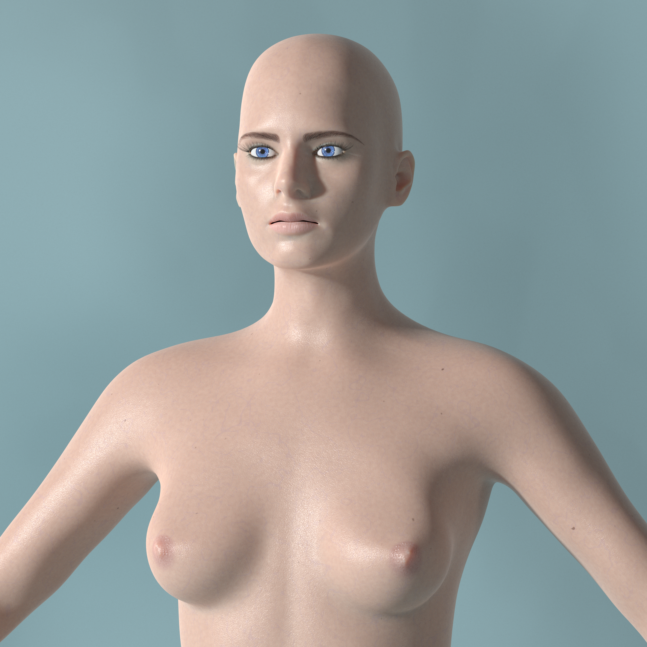

Current status of new skin shader. Note tweaked bump layer for aureolae, the subdermal veins color variation and the tweaked spot layer.

joepal wrote:Current status of new skin shader.
It looks great. Is that a Blender shader?

Postby joepal » Sun Jan 15, 2023 2:16 pm
Yes, it's a mostly procedural blender shader. The only non-procedural parts of the skin in the image are router images for determining which aspect of the material to add at which position of the body.
I've uploaded an early demo of the material here: http://www.makehumancommunity.org/conte ... 30115.html
Suggestions for improvements are very welcome.

Postby joepal » Sun Jan 15, 2023 9:49 pm
There are most likely nodes in there which require 3.4

joepal wrote:There are most likely nodes in there which require 3.4
Yep. Maybe it makes sense to specify the required version of the program?
In my opinion — the skin texture is excellent! The idea of veins under the skin is great…
I'm looking at everything from my point of view — transferring it to the game engine. And there are big problems with shader portability. In the new version of the engine, the shaders are significantly redesigned and not finished yet. There is no full-fledged documentation, of course, either. :(
