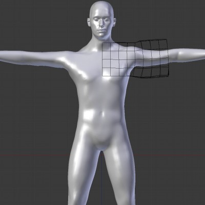

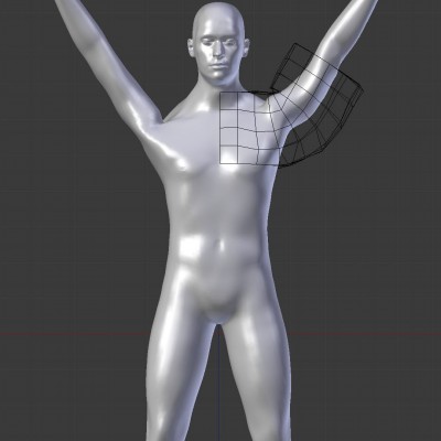

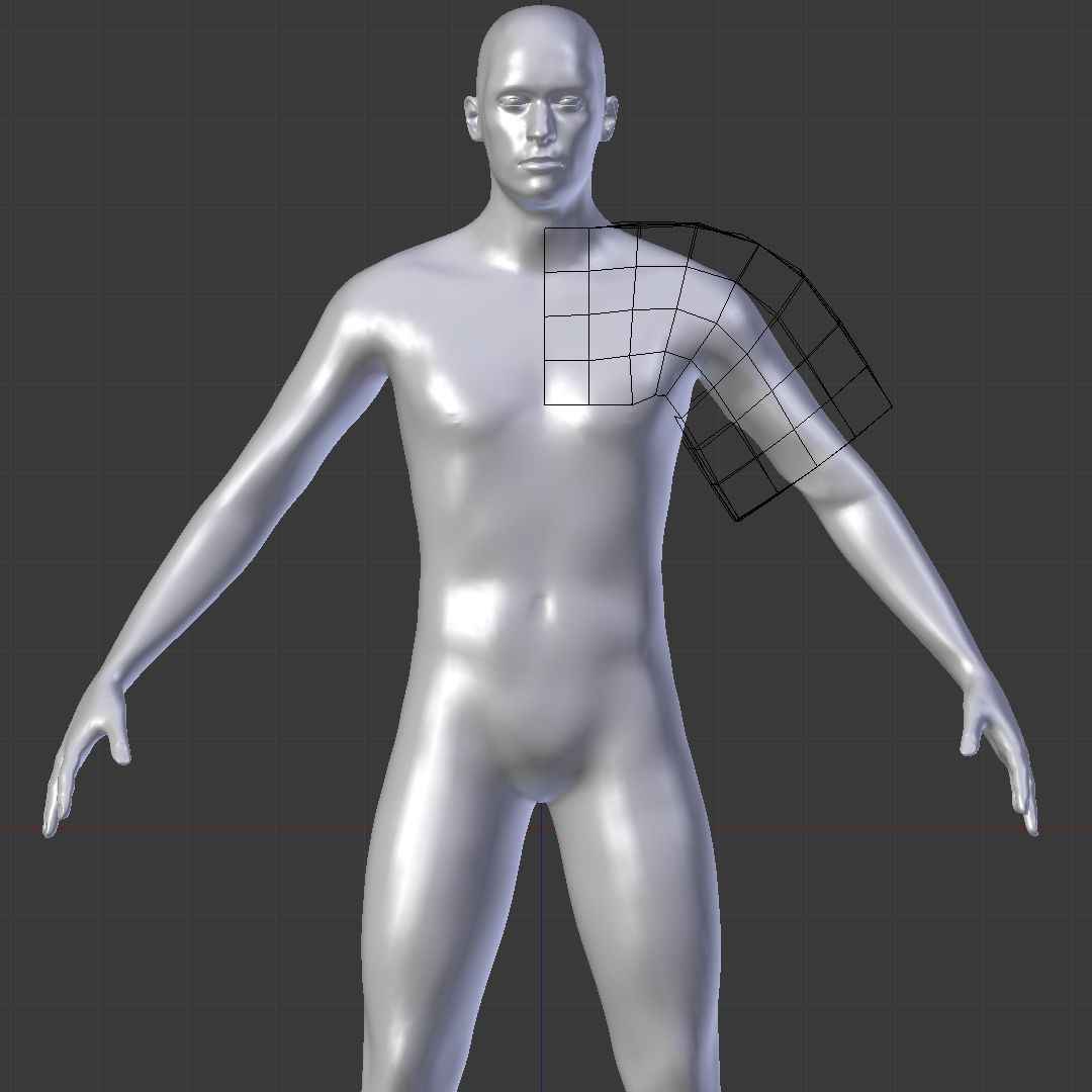

Postby blindsaypatten » Thu Oct 11, 2018 5:04 pm
I have been experimenting with a shoulder cage, with encouraging results. In these images the shoulder on the left is with the standard armature, the one on the right using a deformation cage that is controlled by the standard armature. It's a rather crude mesh and I haven't added any shape keys.

Postby joepal » Thu Oct 11, 2018 9:00 pm
It's an encouraging experiment. Especially arms upwards have always been tricky for MH toons, even with MHX's corrective shape keys.
