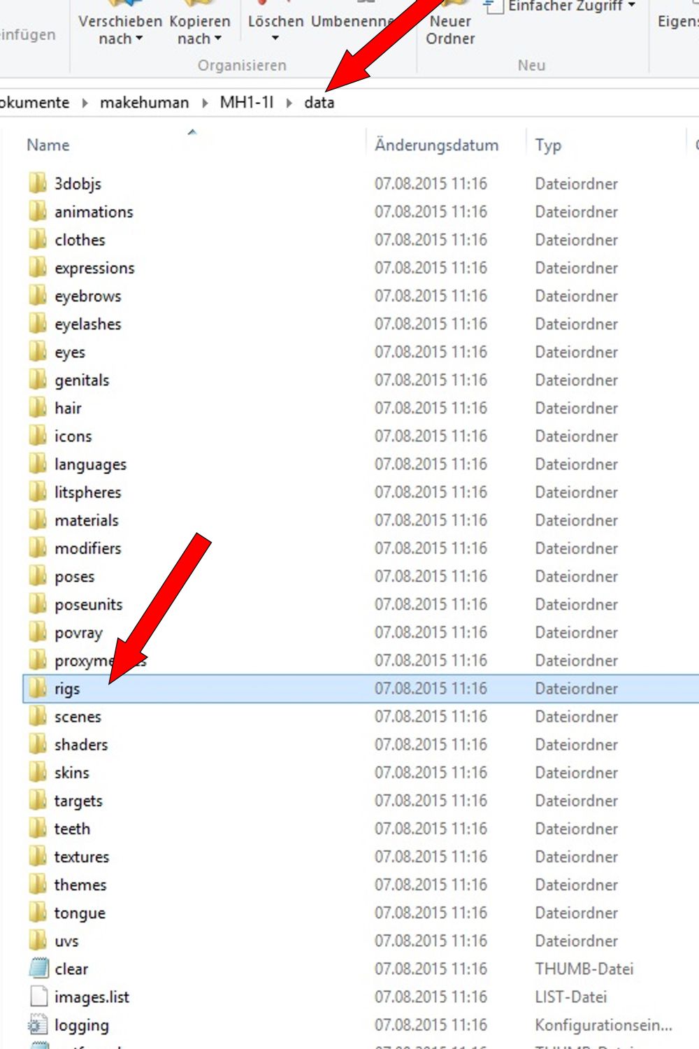

As long as the rigs in the current Nightly Builds are not complete, you can just replace the rigs by those of an older version (1.1). When you haven't saved an older version, you can download the rigs here: http://bit.ly/1HEnFIe
The picture shows where you will find the rigs.

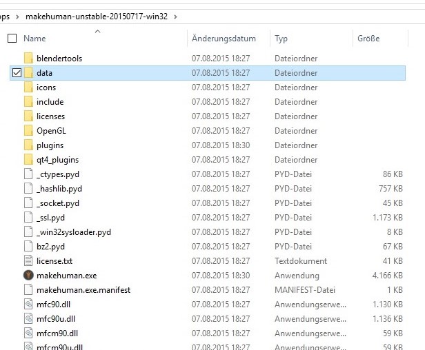

Hi Déesse,
based on your screen shot, it seems your are copying the extra stuff to the program folder of MakeHuman. It might be better to use the working directory of MakeHuman to store this stuff. It's the same folder where your models are stored. I assume the path to this folder is something like "..\Documents\MakeHuman\v1\data\rigs\" on Windows.

You are right, my path seems to be a bit confusing ... :oops: I have several MH-versions running in my 'documents', extracted to an upper folder called 'makehuman' (sub-folders called MHA8 or MH1-1xxx). You have to choose the folder called 'data' on the same level as 'blendertools', 'plugins' and the exe-file. It is NOT the data-folder in V1 where the new rigs have to be copied to (on Windows 8.1)

again, it is always BEST PRACTICE to keep program data and user data separate. When reusing outdated rigs, they should be treated like user data. This will prevent file-deletion on e.g. update processes. So DO NOT copy the rigs to the folder where the exe-file is located. BTW when you move the rigs to the user folder, they will be available to all your MH-versions at once, which can deal with these rigs.
