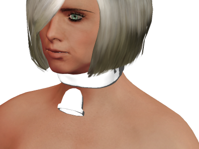

I am going to show you how to fix assets that seem to be broken, regarding color, in MakeHuman that usualy appear as bright white. Here is how the asset "bell_collar" appears on my install:
You can see that this does not look right. The content creator did not modify the .mhmat file to display properly. It is easy to fix, go to the assets directory using your favorite file browser:

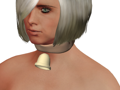

Now we need to reload the asset in the Geometries/Cloths tab in MakeHuman, remove the asset from the model, then just put it back on. You should now see the following, almost exactly like the thumbnail:
Congradulations, the fix was quite simple. Try experimenting with some other values to see how they alter the rendered images on screen.
