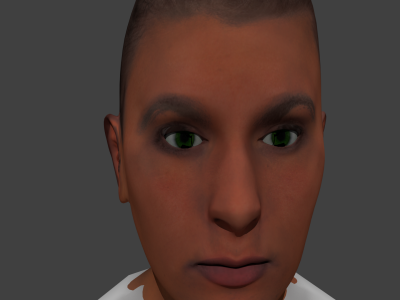

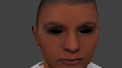

Sorry it took so long to get back to this... but here is what I was referring to:
I used the eye color image to texture the eye. Looked at the UV and it looked good but the eye does not render correctly in Cycles.

Postby ThomasL » Thu Sep 26, 2013 2:30 am
Looks like the cornea has lost its transparency.

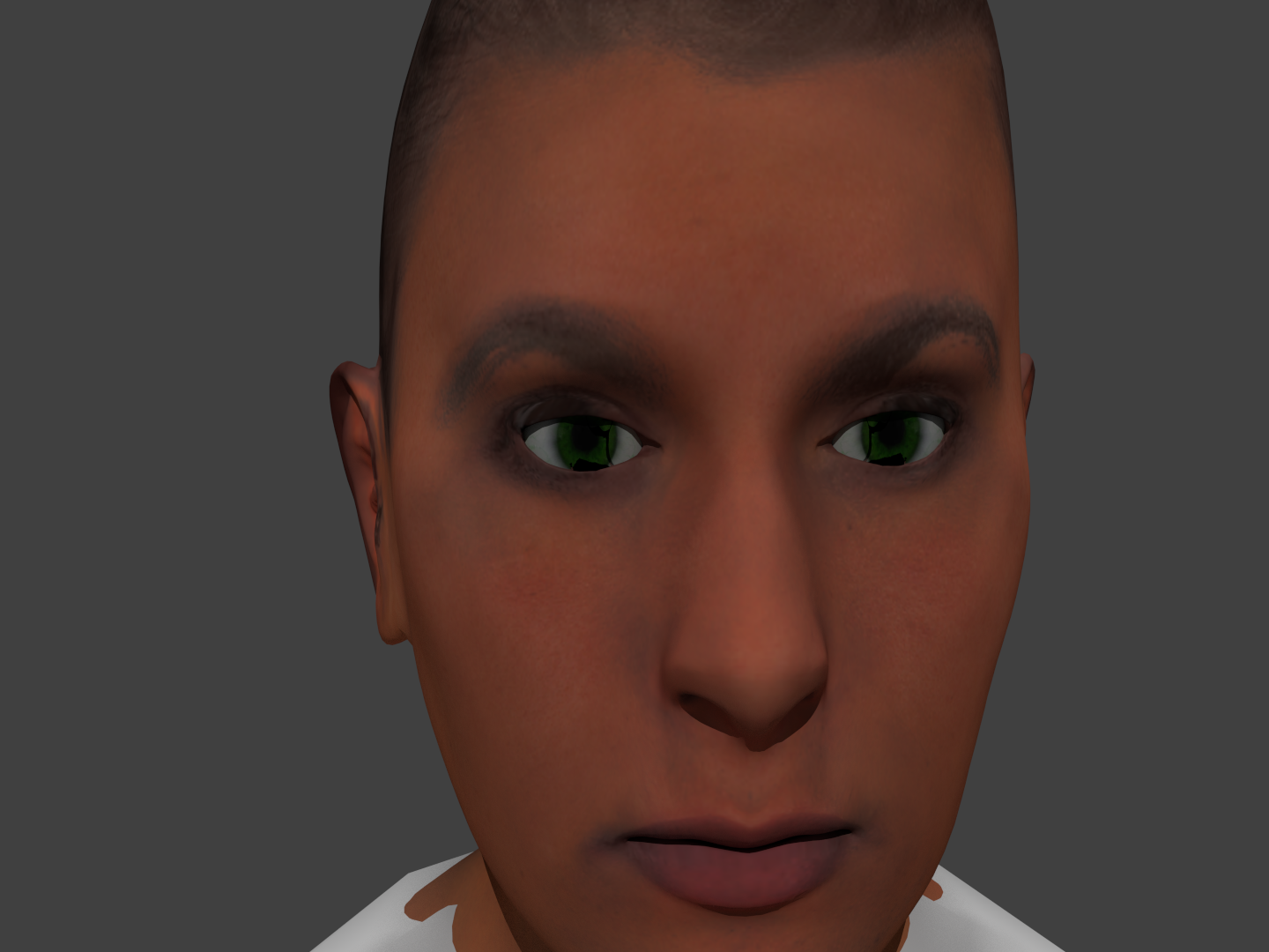

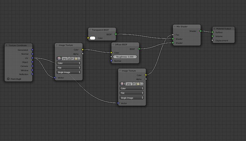

I'm not sure why I didn't think of this earlier but I messed around with adding an alpha to the mix.
node setup in cycles for Lilibeth's green eyes
This produced much better results as here:
Rendered Lilibeth with alpha mask
There are still strange artifacts that I have not been able to figure out how to get rid of, or where they are coming from.
