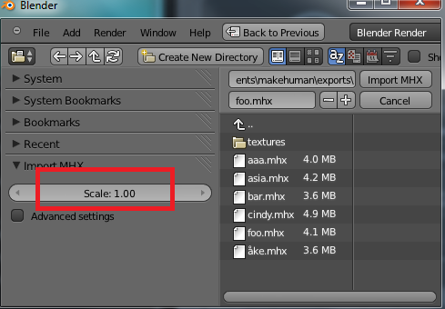

Did you try to change the Scale parameter on import? It is there for a reason.

As I noted in my post, the problem only arises when trying to Scale the model within the program. Yes, when it is imported at its defined size (including the Scale value in the Import MHX dialogue), then the Rig works great (it is even better than Rigify, in my opinion). But there are going to be many, many, many situations where a user will need to change the Scale of his model later on (whether it's for animation or because he realized he miscalculated it earlier or many other possible reasons). In these situations, the Rig does not work properly.
Essentially, as the .MHX rig is now, it basically cannot be scaled after it has been imported. This seems to be a big imperfection to me.
