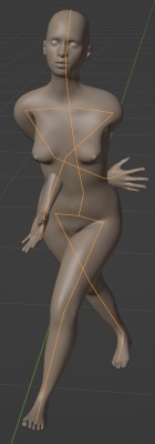

tomcat wrote:But another problem arose:
Blender 3.4
Blender 2.93
Hey TC,
For me Retarget BVH "works" in all Blender versions (now 3.3) just the same. That is, I never get the CMU rigs correctly to work and neither the ACCAD male which looks seriously creepy. That said, your picture for 2.93 has already also distorted shoulders, and I get exact the same result in 3.3.

Postby tomcat » Tue Mar 07, 2023 10:07 pm
PayItForward wrote:That said, your picture for 2.93 has already also distorted shoulders
Nope. Retarget worked correctly in this case. This is a bug in the .bvh file itself. Here you can see that the shoulders are up:
ACCAD male horror
But it's easy to make monsters… there was a suggestion to add the ability to create monsters in the new version, but as can be seen, nothing needs to be done — everything is ready. :mrgreen:

Postby PayItForward » Wed Mar 08, 2023 8:22 am
Oh, I see. Is it a CMU rig? I've found countless flaws in them. It's typically the shoulders and that strange sidewards bent of the head or neck. The top next issue is bone roll of the legs.
I have yet to come upon a single CMU BVH where this isn't the case so I always thought that CMU used just a a peculiar T-pose which doesn't "translate" well into other software. I tried to play a little with changing bone roll and such but I really don't understand much of it so no luck.

Postby PayItForward » Wed Mar 08, 2023 6:36 pm
Yeah, I had a look at CMU, Bandai and ACCAD, too, but for me only the ACCAD female BVH's worked. Even these BVH's had some minor issues, that is, they have basically more or less slightly distorted joints. I was able to fix that mostly by changing "bone roll".
Note, though, that I may be using the term here wrongly since Blender has a bone roll setting in armature edit mode where you can adjust the rotation of the bone around its axis. That is helpful in some cases but that's not what I mean, however.
But I think I can explain better with some pictures.
I used a CMU BVH here with a retargeted Makehuman CMU rig. It has the stereotypical upwards-angled shoulders and the bent head.
My suspicion was always that this not due to a faulty motion capture or a faulty rig but an incorrect translation of bone data. For example the RightShoulder and LeftShoulder bones are in my opinion both rotated approx. 30 degrees too much around the local Z-axis. (The upper arm bones follow that principle unfortunately and you have to adjust for that, too.)
Nonetheless, you can do this quite efficiently in the animation tab's graph editor. Isolate the bone's Z-axis data in the editor window and look at the graph. At frame 0 you see the later added T-pose and it's obviously out of sync with the following data. Mark all keyframes except zero and bring them roughly in line with the T-pose's Z-data. Looks so much better now. You need to repeat this for the other shoulder bone and the upper arm bones but alas it's really not as clear what amount you need it to change.
My theory is that whoever converted the original motion capture data into these BHV's messed up when he later added the T-pose for compatibility reasons. I think Retarget BVH uses the "incorrect" T-pose in the first frame as a reference and applies its values to all the other frames, thus giving an incorrect result.
Maybe it would be a solution to get rid of the T-pose in the BVH's and then retarget the data without it.
I don't understand much of that, however, so I'm just speculating.
