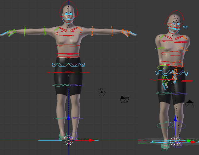

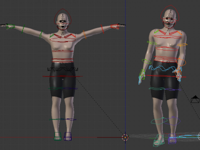

The next two pictures show the same frames (0 and 37) from a CMU bvh file, with the default MakeHuman T-pose and a user-defined T-pose, respectively. The user-defined one looks strange as a T-pose, but yields better results for arms-down poses. However, using the T-pose is not a panacea, because retargeting of poses close to T will probably be worse. But then again, your character will probably seldom be close to T-pose unless you animate something like a crucificaction scene.
