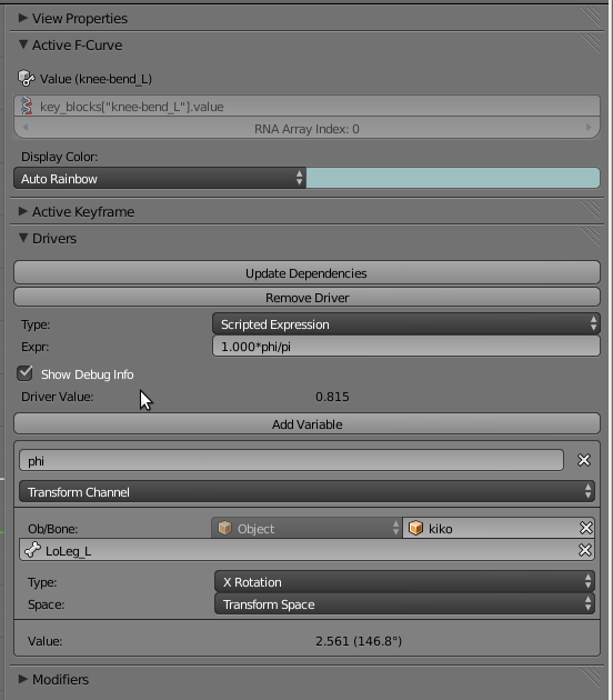

...and when I try to add a driver of type "Scripted Expression" with a var related to "Rotational Difference" to that shape key Blender 2.66a simply crashes...
Solkar
Posts: 63
Joined: Thu May 02, 2013 5:34 pm
Re: Leg deform
Postby Solkar » Tue May 07, 2013 10:14 am
..still no idea why that craches, but HEUREKA!
This
does the job ("kiko" being the name of the armature).

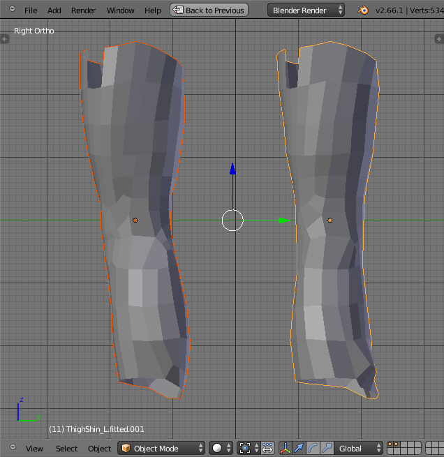

I'm currently working on python-scripting that key creation and driving.
I'm wondering if, because of the very simple form of the backside of the human leg from just underneath buttock to just above ankles, one could try surface fitting that with a low-order polynomial and work with a bit of diff'geo and measure to get a correct volume-preserving morph.
Unfortunately I'm not overly familiar with numpy/scipy; I normally do numerics with Fortran and C++ only.
From that I know (and appreciate) http://www.ics.forth.gr/~lourakis/levmar, which is an implementation of Levenberg-Marquardt (wiki, [Mar63]) algorithm.
The core would not have to be an mh runtime module, but only a develoment tool for generating shape keys - would that also violate mh "pure python" philosophy?

Solkar wrote:I'm wondering if, because of the very simple form of the backside of the human leg from just underneath buttock to just above ankles, one could try surface fitting that with a low-order polynomial
A polynomial fit indeed works quite well - even with a scipy-ignorant like me at the keyboard curve_fit's resistance was futile
Of, course, a polynomial ansatz is not exactly brilliant, a z-axis harmonics and elliptic xy-profile give quite a natural ansatz function and put more value in it - I stay tuned to that.
