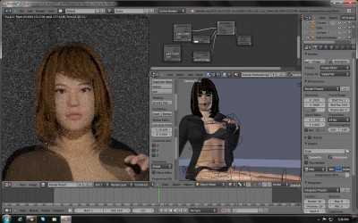

hello there, I kinda made the hair textures work in cycles
this is what I did:
hair nodes
