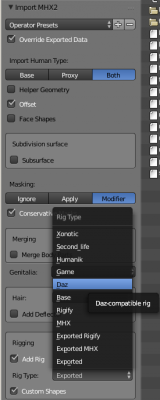

Since this section is about Unofficial plugins, I presume that you talk about MHX2. All skeletons from MH 1.0.2 can be created by the MHX2 importer. Select Override Exported Data, Add Rig and choose the appropriate Rig Type. One of the SL skeletons have been renamed Daz, because these bone names are used by many DAZ and Poser characters. But the 26-bone SL skeleton is probably the other, just named Second_life.
