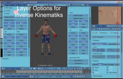

Hello,
Problem i dont see the Layers for the FK-IK Switch
It should look like that. Left and rechts side has those switches i would need to get my inverse Kinematics
Is there a way anyone could perhaps help me out?
I try to get an answer for long time now, but i dont find it...
so i would appreciate any minor help. Thank you.

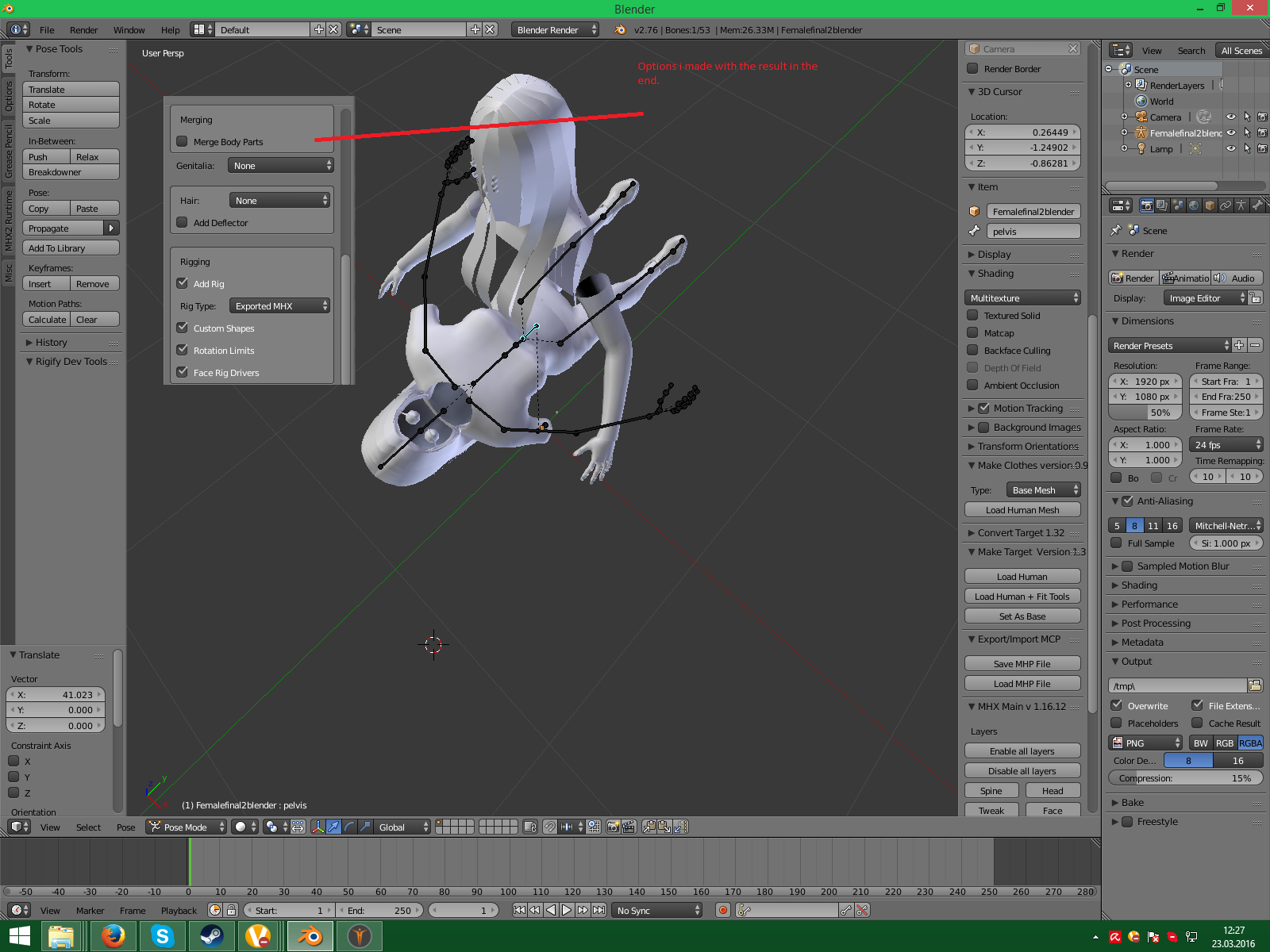

This is the Result with Exported MHX
This seems to do more with just MHX but it still not makes me able to use inverse kinematics at all. i cant move the whole body like i want to.
so what to do? or do i need to do the invsere kinematics manually?

This works fine for me, which makes me believe something is astray with either your procedure or your installation.
I have the ik/fk switch
Further suggestions on what may be wrong:
* You're using MakeHuman 1.0.2. All development is targeted at 1.1.0, and it's possible newer mhx2 versions are glitching with 1.0.2.
* You have made an export for mhx2 a while ago with a different version of mhx2, and try to import it with a newer mhx2 which has changed somehow
* You have exported a character from MH with a skeleton which was not "default" or "default-no-toes"
What exact versions of MH and MHX2 are you using? And what options and skeleton are you using when exporting from MH? I see from the screenshots that you're using blender 2.76, which should work fine.
