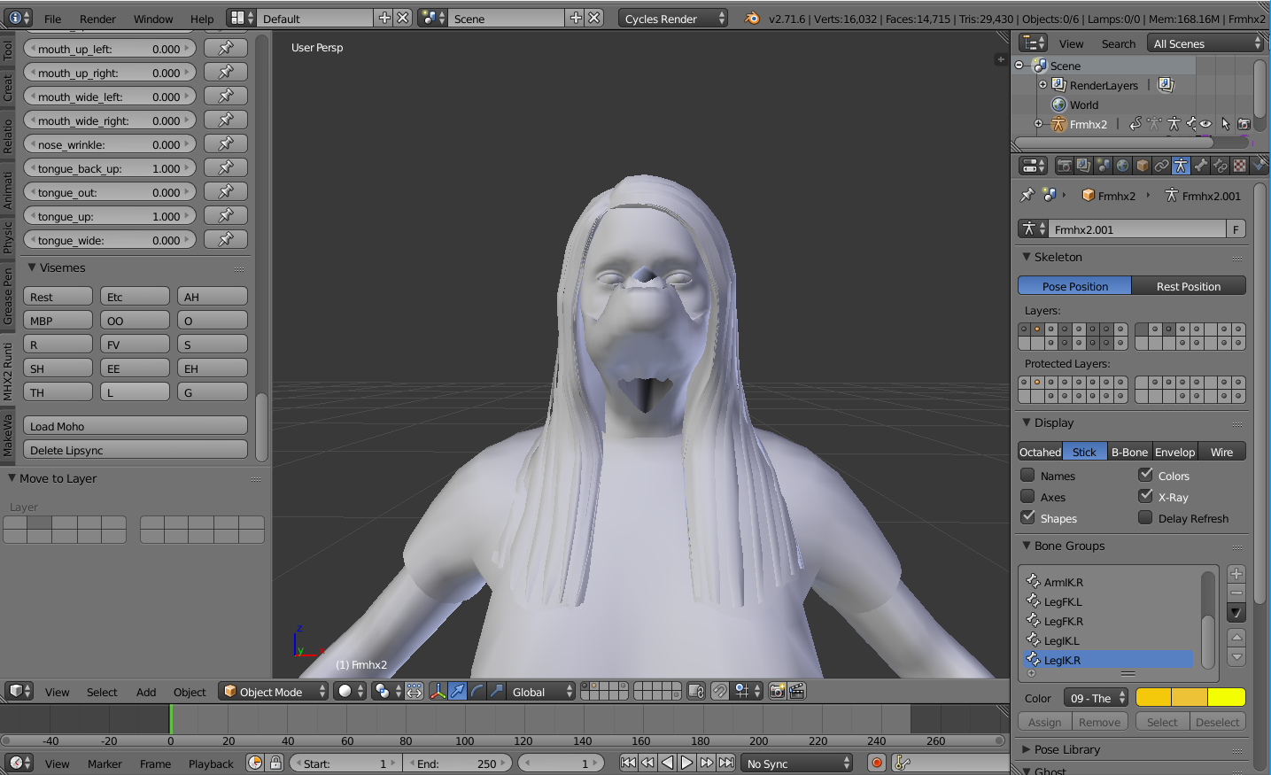

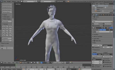

Thanks for responding and understanding. I Imagine that the coding and setting things up is a very time consuming task. This is what i'm referring to. It seems the vertices in each shape key are not connected thus leading to distortion when used. I read the documentation before I installed it. I used the mhx rig . The driver panel is different from the one in your document. Maybe I did get a buggy download but these are the results I get from the viseme panel.

It is difficult to tell what has gone wrong, since MHX2 has been heavily developed recently. Remember that the project started less than two months ago, and even if some older code has been reused, things have been very much in a state of flux. This is changing now. A I just wrote, http://www.makehuman.org/blog/mhx2_stable_version_023.html, there is now a version of MHX2 which I consider to be feature complete and quite stable. It can be downloaded from https://www.dropbox.com/s/04na6ls7ue4ogtn/mhx2_stable_023.zip?dl=0.
Btw, from your pictures it looks like a scale issue. If you exported from MH using meters, and your version of the MHX2 importer did not rescale the shapekeys from the default decimeter units, things could look like that. Anyway, the stable version handles unit conversion of shapekeys correctly.

ThomasL wrote:It is difficult to tell what has gone wrong, since MHX2 has been heavily developed recently. Remember that the project started less than two months ago, and even if some older code has been reused, things have been very much in a state of flux. This is changing now. A I just wrote, http://www.makehuman.org/blog/mhx2_stable_version_023.html, there is now a version of MHX2 which I consider to be feature complete and quite stable. It can be downloaded from https://www.dropbox.com/s/04na6ls7ue4ogtn/mhx2_stable_023.zip?dl=0.
Thank you very much! I downloaded mhx2 6afc2983d26 and it worked spot on. I will download the latest version. Thanks for the link. Nice work I do like the features and I have been exploring all the things that the addon does. Great Job ! My interest in makehuman has once again peaked. Thanks again.
