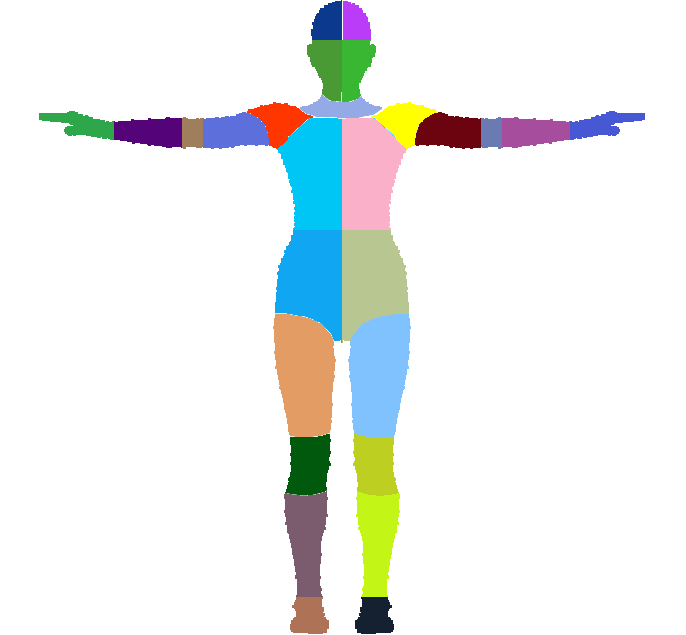

Postby duststorm » Fri Aug 29, 2014 1:01 pm
Those badypart mappings (the ones used in Koen Buys' publication) were created by me.
I did it by first creating a reference image
http://jonas.ejibe.net/ul/wiki/images/f ... apping.png
Then I set the image as background in Blender, aligned it with the mesh, used wireframe view (ortho camera) and selected the required polygons using the lasso tool in blender (CTRL+right click and drag). I did not use any symmetry tool, I just made sure that it was (more or less) symmetric. It can be done pretty quicly.
http://jonas.ejibe.net/ul/wiki/images/4 ... beling.png
Note though that this was done with the HM07 basemesh (of MH alpha 7). You will need to make a new mapping if you want to use the HM08 mesh (MH 1.x).

Postby user12345 » Fri Aug 29, 2014 2:25 pm
duststorm wrote:Those badypart mappings (the ones used in Koen Buys' publication) were created by me.
Could you please check your inbox?
