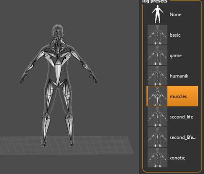

Now for the problem I am facing , is there any way I can easily morph the mesh generated in makehuman using blender.I don't know too much in blender but I suppose I can use it to create morph targets /shape keys.It might sound noob-y but should I use the muscle rig to mprph the human body?.

prasht63 wrote:should I use the muscle rig to morph the human body?
No, probably not. Skeletal rigging and blendshapes are two entirely different techniques for modifying and animating a mesh. I don't see much use in the rig for your project.
